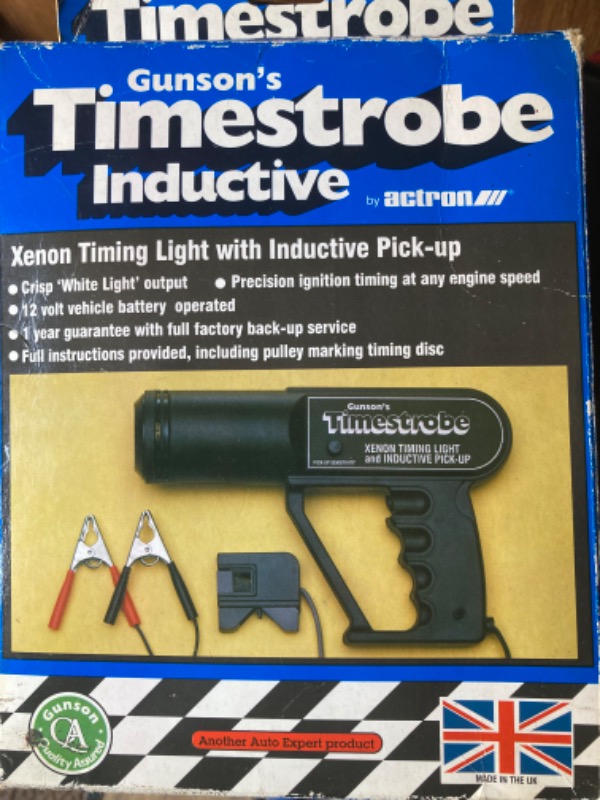

This is my strobescope
as the inductive clamp goes across the HT lead at 90deg it doesn’t matter which way you put it on.
