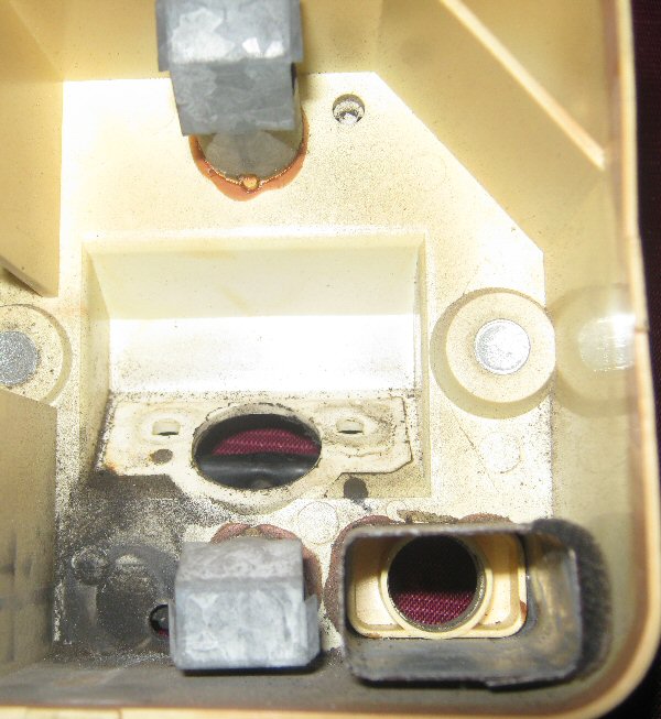

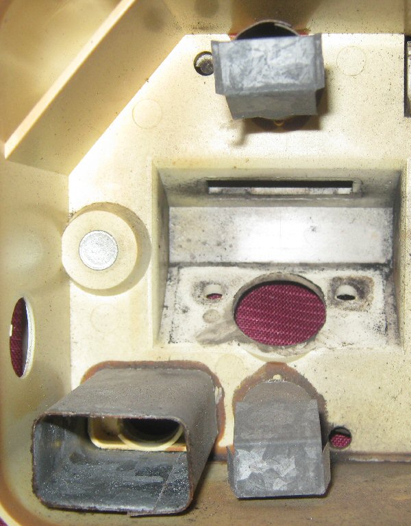

Sorry for the delay! I wouldn't worry about the bulb covers for the instruments/gauges. Personally I can't see their advantage. With 360 degrees of light from the instrument LED's, covers are not wanted as you want to use every bit of internally reflected light to back-light the face-plates. The covers (tunnels) for the signal indicators should be used !

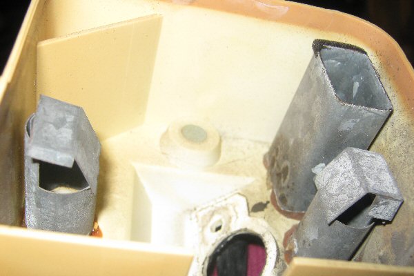

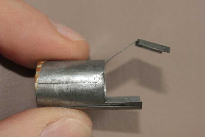

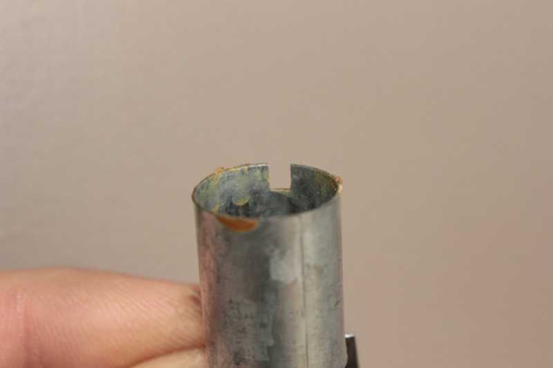

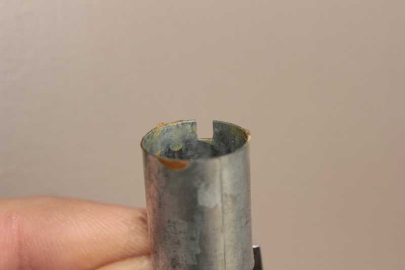

re: your question about the tin covers etc. I had suggested that you not worry about them so the light can reflect 360 degrees within the housing. In hind-site I'm taking a step back. Those tin covers may actually be necessary to dissipate the heat from the bulbs! Although small, they are non the less capable of getting hot. (Not so much the signal indicators) As to which way they are oriented: The notch should align with a corresponding tab at each position. The angle shown is how they came out of my mine - otherwise untouched. If you are going to reinstall the shields I would consider using some metal polish to see if you can shine-up the reflective side. They are retained in position over the raised "lip" with some contact-adhesive.

Yeh knew about the notch, the thing I was wondering about was the shape of the top piece, a set of gauges I have looks like someone has bent the tops and was wondering what shape they were suppose to be, got a spare set of gauges and the tubes look like they haven't been "modified", just have to get the others back to the proper shape, guess the thought is to use the inside white case to defuse the light??, cheers
