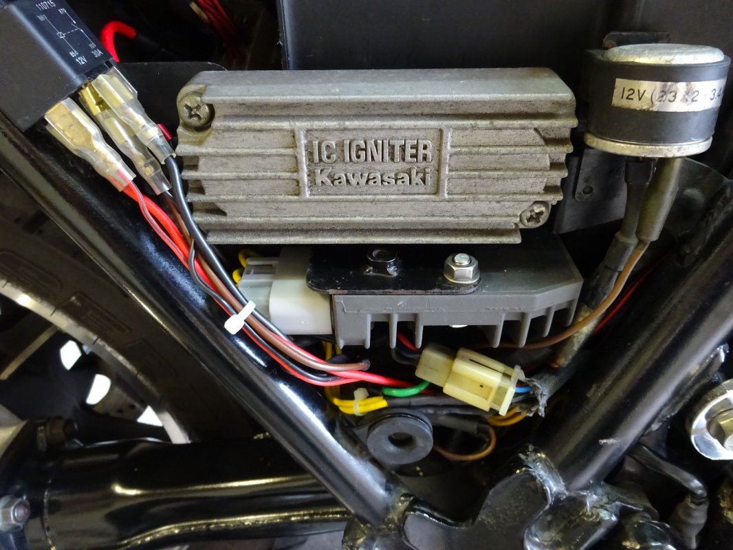

The "next upgrade to the Shindengen FH020 which is a mosfet shunt regulator is the latest series regulator SH847 from Shindengen. Instead of shunting the unwanted current to ground when the battery is full and the circuit demand is low, the newer series regulator turns off and on the feed coming from the stator. The end result is less heat generated at the stator since the "flow" of current is lower. Reports from end users suggests that oil temps in the engine run around 10 degrees F cooler, so an added benefit.
Anyway, roadster cycle is the only place I would buy from. There's a lot of fakes on the market especially on FleeBay.. Check out Roadster Cycle.

Re: kz 1300 battery
Agree with Kawboy that a series regulator is the way to go. Looks after the stator and reduces heat to oil. The SH847 is a monster and will not fit in the same space as the original OEM regulator. I bought a genuine Shindengen SH775 series regulator (search ebay for "NEW SH775 voltage regulator rectifier Polaris Ace Ranger RZR EP4T ETX 4012941") but beware of fakes! This is rated more appropriately for the relatively low alternator power of the early Z1300's. With a bit of simple metalwork, it will also fit in the same space as the original.
