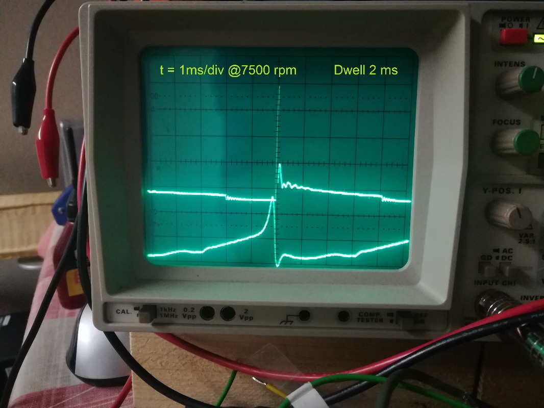

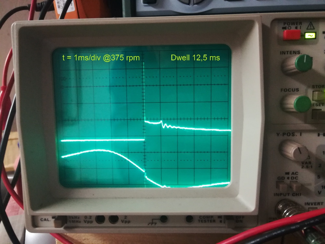

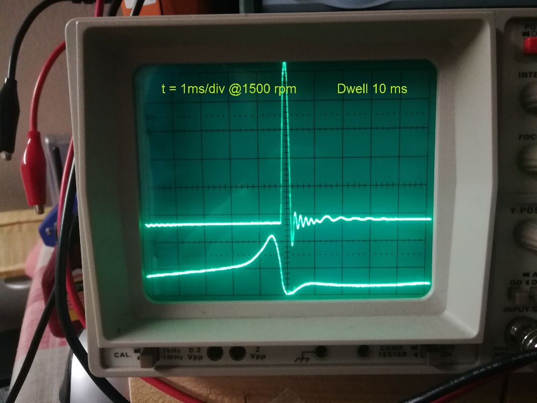

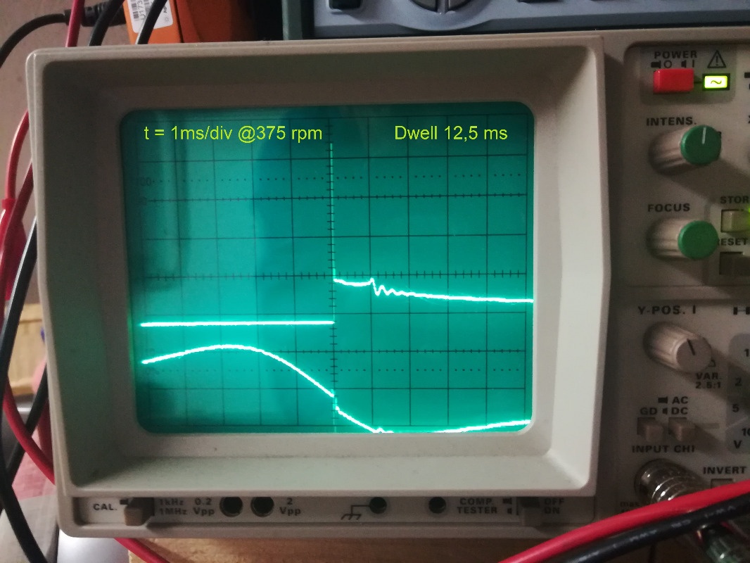

First three pictures are taken under following conditions:
Spark plug BP6E-S
Pressure 9 Bar
Suply voltage at 14,6 Volt
One spark plug firing in pressure and the other one outside.

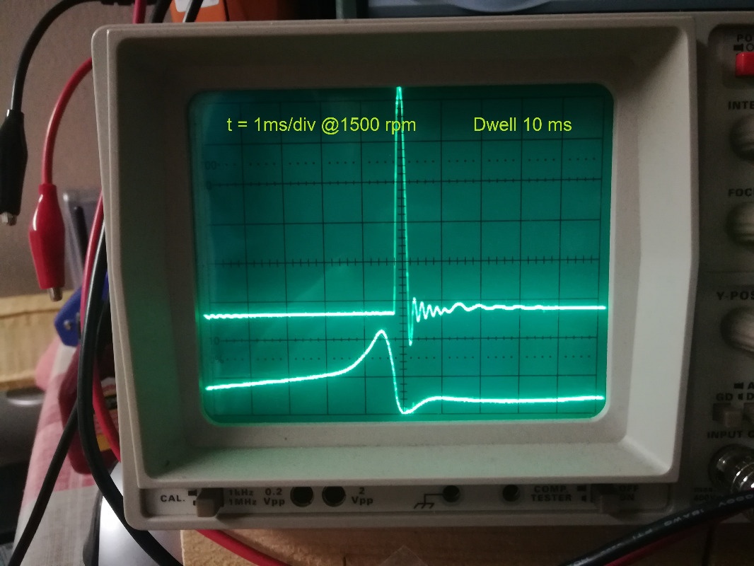

Now following three pictures conditions:
Spark plug BPR8EIX
Pressure 9 Bar

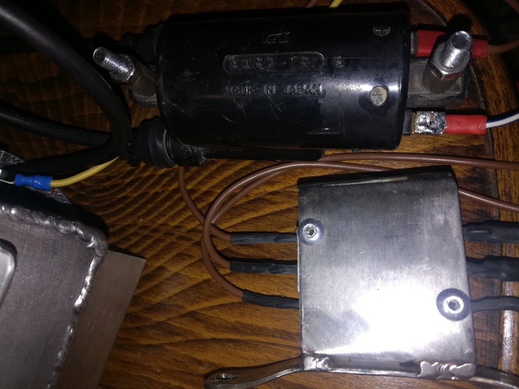

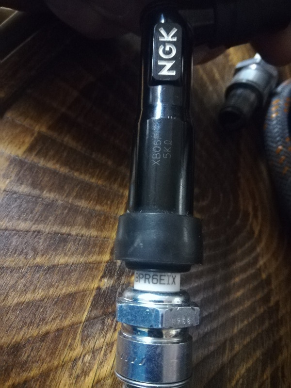

Test equipment consisted of upgraded version of kawasaki ignition which means smaller ballast resistor (0,6 ohm), AW82-TRI ignition coil (primary resistance of 2,26 ohm) and standard igniter, source of the input signal standard Z13 rotor and coil. Spark plugs caps are with suppressing resistor fitted 5Kohm. Supply voltage 14,6 volt. I have try to set the standard system at its best setup for highest performance to see if new stuff can top it.

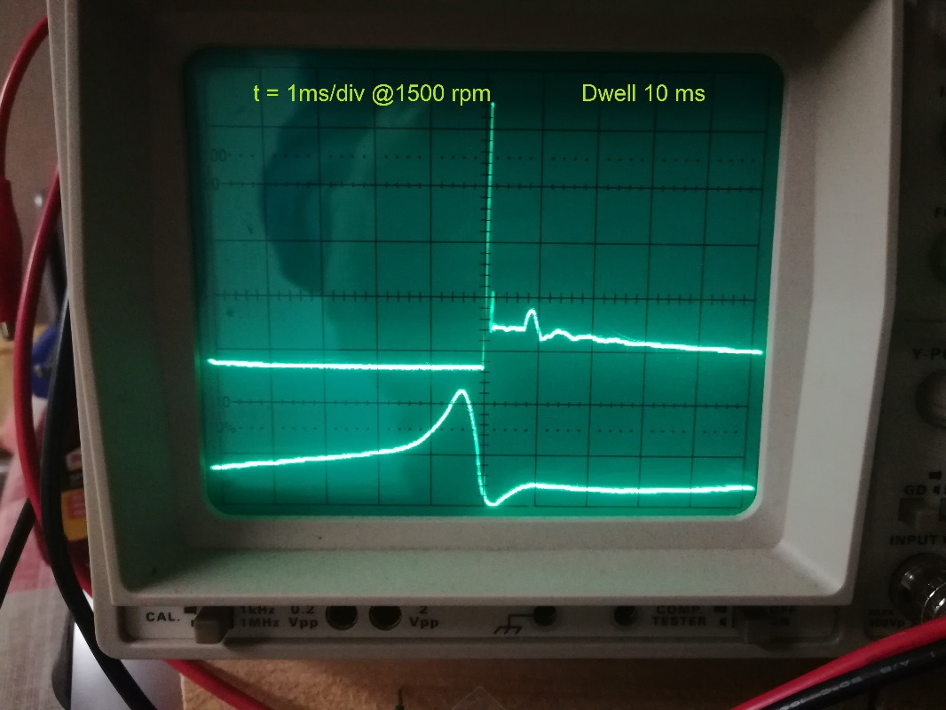

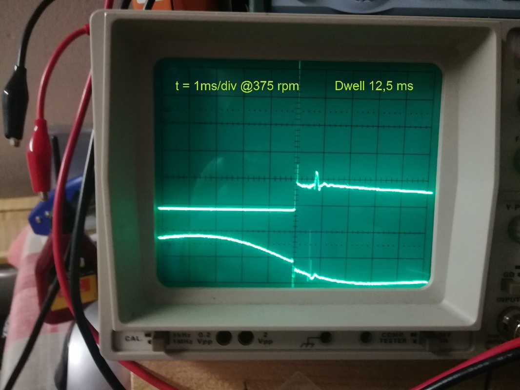

Spark plug BP6E-S
Pressure 9 Bar
Spark plug BPR8EIX
Pressure 9 Bar

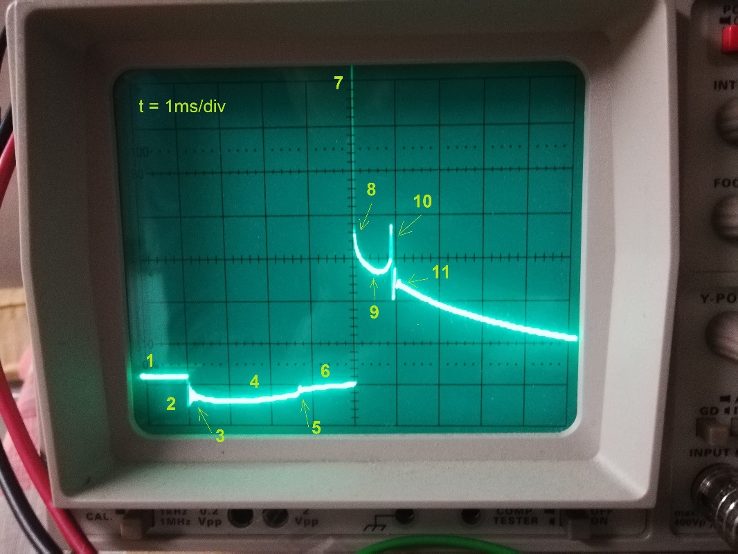

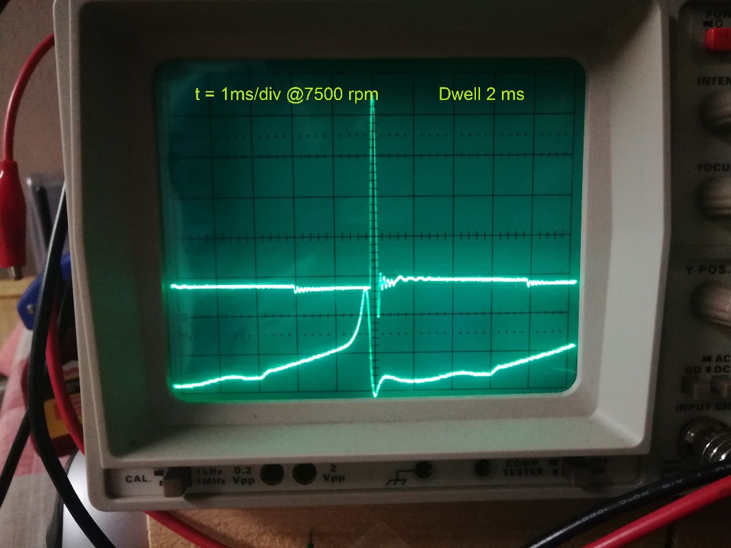

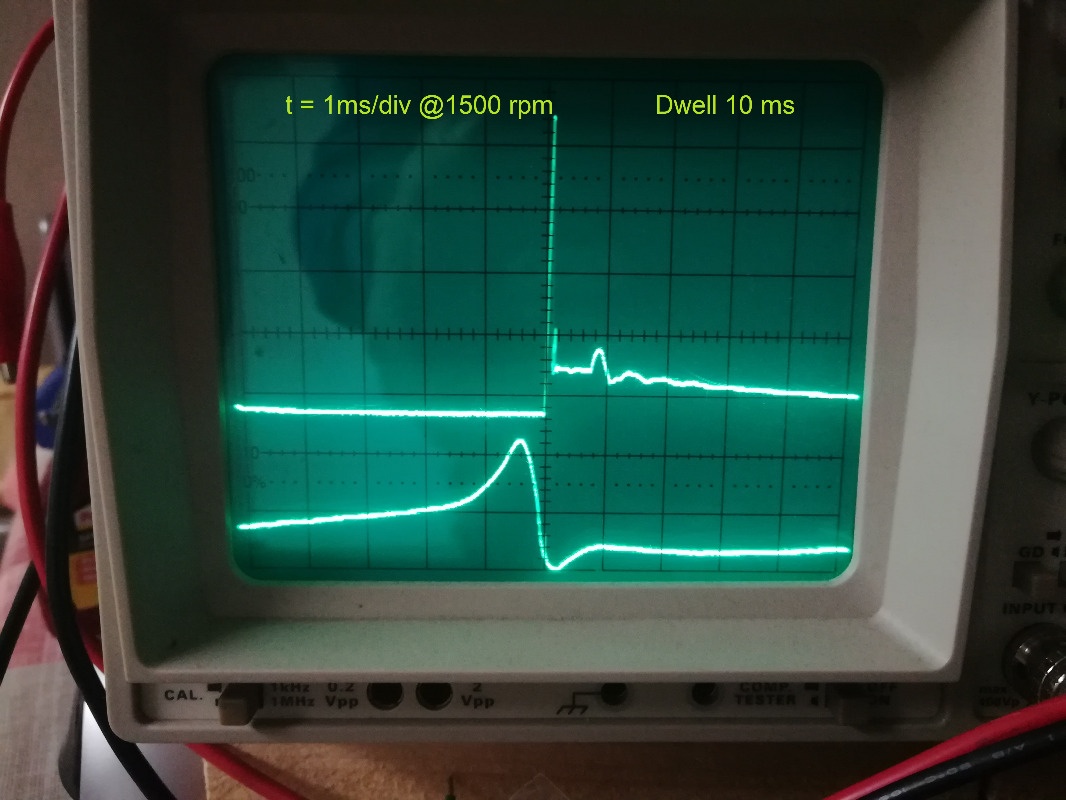

6 years 10 months agoSo here is the picture of good and healthy ignition wave. There are some important points which we are going to compare later. Now for those who is not familiar with ignition waves some explanation.
First and most important: I'm discussing the secondary winding of the ignition coil in this example, so we don't mix stuff up and make it easily understandable for everyone.
Point 1, the transistor is open, nothing happens and voltage sits at for example 13,5 volt if you would be looking at the primary winding.
Point 2, the moment when the transistor of the igniter closes, Dwell begins.
Point 3, the transistor is closed and current flow begins. The oscillations depend on the type of transistor used but is not relevant here.
Point 4, the current flow charges the coil with energy.
Point 5, internal current limiting circuit takes over and cuts the current flow down.
Point 6, the time of current limiter being on, at high rpm's it will disappear.
Point 7, transistor from point 3 is now open, and electrons start to push across electrodes. Spark is initiated.
Point 8, oscillation due to R-C properties of the secondary winding.
Point 9, current is flowing between electrodes, there is a spark.
Point 10, the spark ends here.
Point 11, left over energy disappears with in the ignition coil.

That's a healthy spark of 9ms? What did you generate that with?

Kawboy where you got 9 miliseconds from? You mean number 9? Hmmm. The spark here is burning 1 milisecond on this example. In the left top corner i indicated this, t = 1 ms/division.

6 years 10 months ago - 6 years 10 months agoDaro wrote: Kawboy where you got 9 milliseconds from? You mean number 9? Hmmm. The spark here is burning 1 millisecond on this example. In the left top corner i indicated this, t = 1 ms/division.
I assumed each vertical bar was 10 ms and each graduation was 2 ms. But even that wouldn't make sense.
