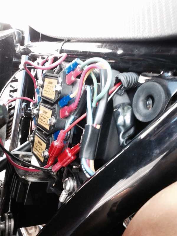

I have a 1979 model and I replaced the IC Igniter with 3 GM HEI 4 pin ignition module #40600 which can work with the magnetic pickups.
Its been over 3 years since I did this mode and I never had an issue what so ever.
These ignition modules are between $35-65 US depends on brand, I installed modules from JEGS.
I posted about it over 3 years ago and its somewhere in this forum
For me it is a good solution for this issue

Mine was missing the igniter & at the time, they were like $800 each...used..
so I did this:
gpzweb.s3-website-us-east-1.amazonaws.co...ion/GPZgmHEImod.html
Should also note, mine had buick coils in it. Anyway, hot enough to knock me on my butt, & the bike liked it fine.
Todd
so I did this:
Todd
