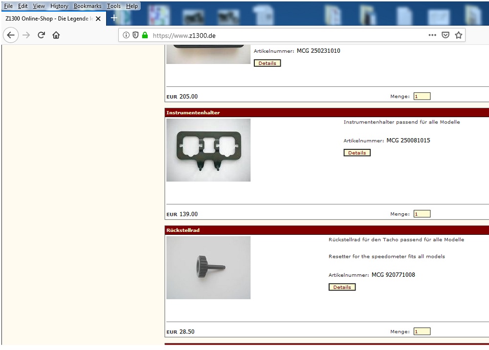

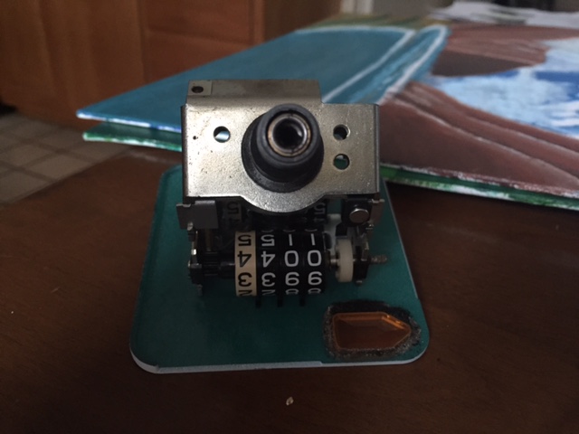

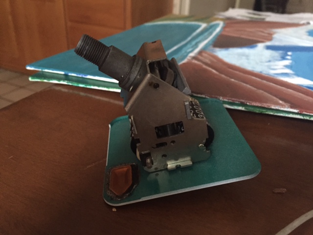

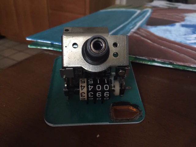

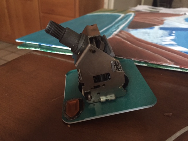

Hi, if you've no options left than its better to cut it than break something inside while trying to unscrew it. Whatever happens just take you time you still got some options. Here is the knob (instruments section), and couple of pictures i got, nothing much usable but it will give you some idea. If you need than I'm willing to dismantle my tacho and make photos as guidance.
Daro
Daro

Thanks Daro, really helpful - yes, my main focus will be to cut away the end of the knob as gently as possible so I can extract the instruments from their housing. I have not quite worked out whether it would be best to clamp the knob in a makeshift vice whilst also supporting the housing and gradually drill away at the centre hole - using progressively larger drills to only take a small amount of material at a time - or to use a small Dremel high speed cutter and gradually nibble away at the centre.
I also saw that MCG sell a replacement knob so that was my first target purchase - I might also get the needles just in case as mine look a little frazzled.

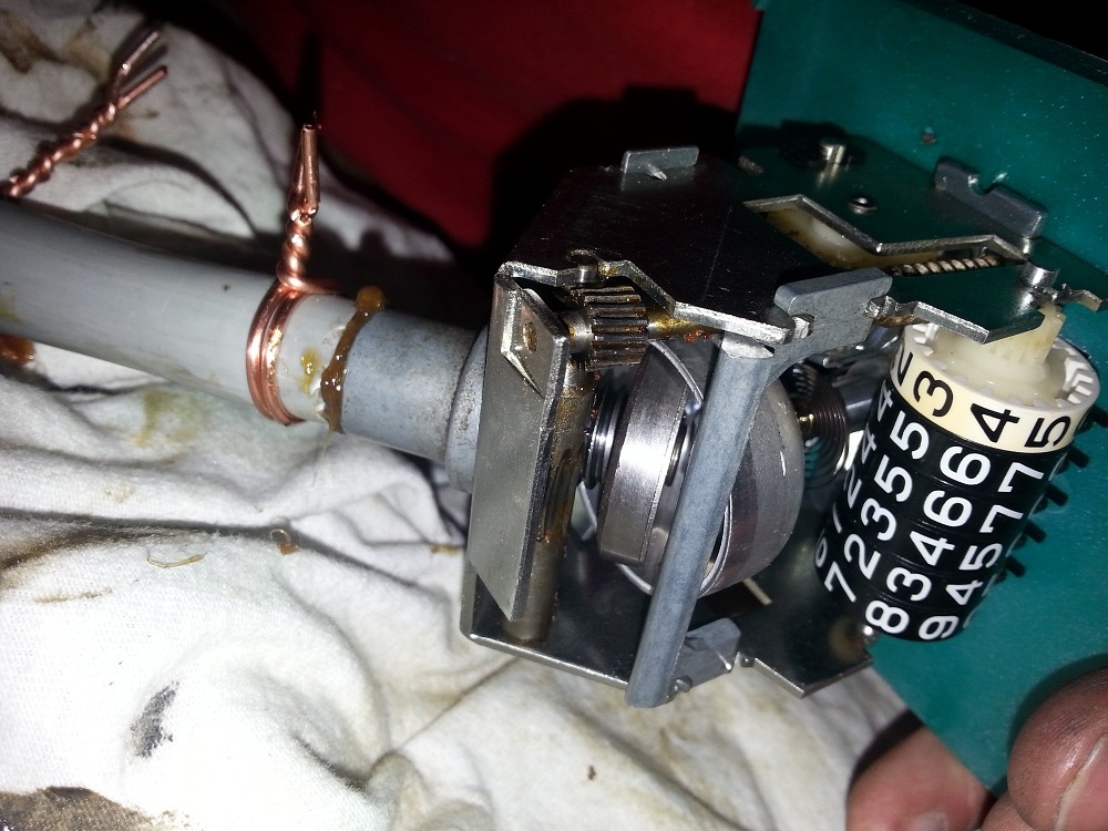

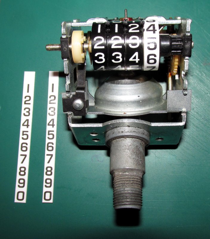

I was interested in a picture so I could work out if it would be possible to remove the remainder of the knob once the speedo had been removed - I eventually found a picture on this site that looks helpful but appreciate your offer to explore further - I would not want to burden you with any dismantling of your own meter!
From the pic below it looks like a) the threaded part of the trip shaft is exposed sufficiently to remove any remnants of the knob and b) should be possible to grip the other end of the trip shaft to apply more torque to remove the remaining parts of the knob.
