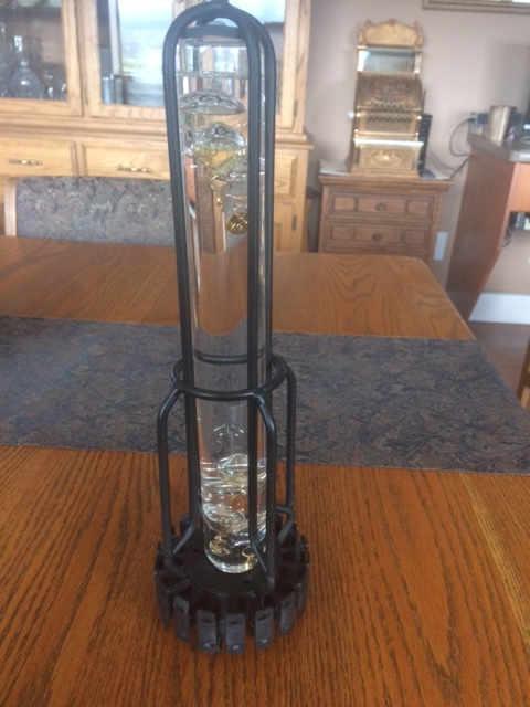

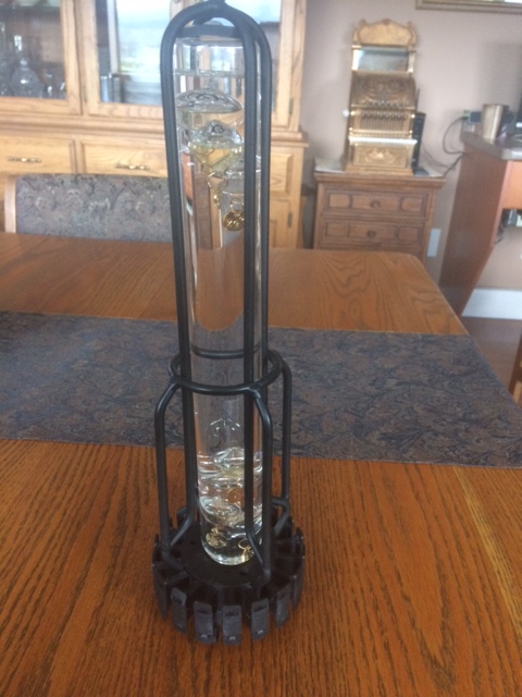

I kept one of the burned-out stators and removed the winding's, keeping count of the # of "wraps". I had intended on re-winding it myself but given the reasonably low cost of a replacement I simply got lazy and never did get a re-round to it :blink: It did make a unique base for my Galileo Thermometer so it wasn't wasted !
