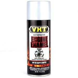

Checked for continuity between the phases and two are shorting to earth. I guess that's why the previous owner took the bike off the road due to charging problems. Anyway, crankcase covers will be off to the chromers shortly whilst I get on with painting the engine. I'll be using this stuff as it appears to be the closest match
[attachment=
SP995
ENGINE ENAMEL
CAST ALUMINUM
SP995
ENGINE ENAMEL
CAST ALUMINUM
