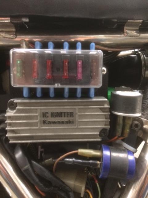

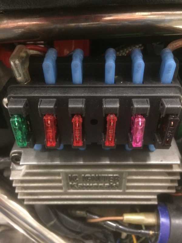

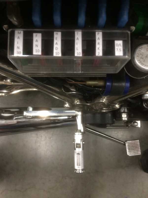

Easy to do. I unsoldered the wires by pair from the stock fuse carrier and crimped 90 degree terminals. No cutting/lengthening of wires was needed. The 6th fuse is used for a driving light relay and is powered directly from the battery. The 30 amp MAIN and 10 amp FAN are "Bussed" together on the stock fuse block to give the fan power when the key is OFF. It wasn't practical to make a Buss-Bar to bridge two fuse blocks internally so I made this required connection in the form of a jumper-splice between the wires on the outside of the fuse-box. The mounting plate is 4mm Phenolic. It mounts in tandem with the Ignitor. Fits comfortably under the side-cover.
There was no specific reason for doing this mod. but blade fuses are available almost everywhere, where as the 20mm glass fuses are not common. A more convenient location as well, for my purposes.

The fuse block is made in a modular design. Once the back plate is removed all the fuses come out individually, in their own two piece case. The fit and design is such that I didn't want to cut-up the fuses or the case to facilitate a Buss. Not so much lazy as practical in this case. The Jumper-splice works just as well.
The blade fuses are held very snug. The glass tube fuses, not so much, relatively speaking.
Should mention this: I have a proper crimping tool. As there was no way to solder this style of 90 degree spade connector, the crimping tool assured me of a mechanically and electrically sound connection. Trying to crimp ("crush") a connector with pliers or the like is a poor idea.
