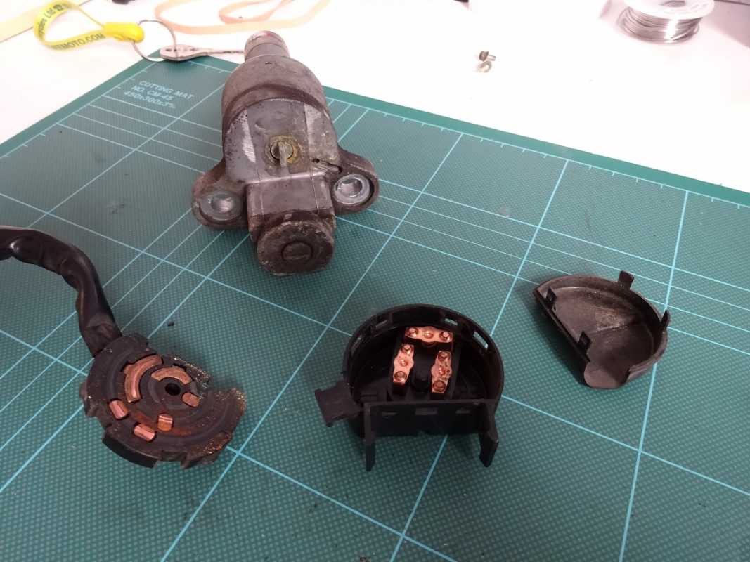

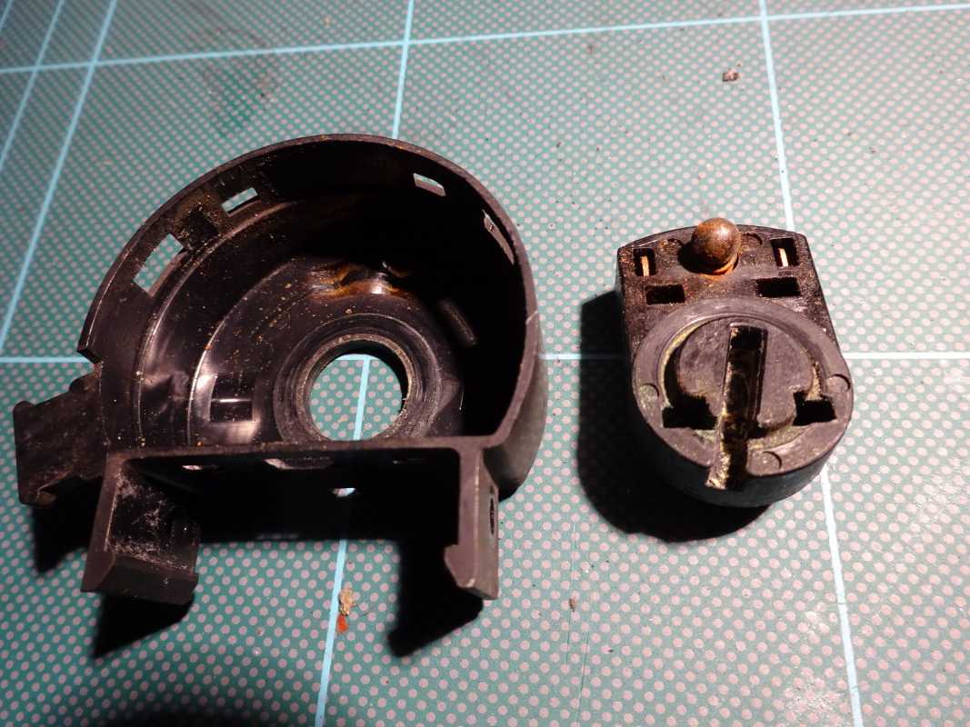

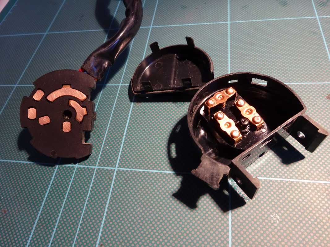

Ignition switch: First challenge is to prize this apart once you have removed it from the top steering yoke. The cover was relatively easy but I used a couple of small flat blade watchmaking screwdrivers inserted between the main housing and the main contact plate (centre and left respectively in picture below). After 37 years, the plastic housing can be brittle so this requires some care and patience! The deposits and wear on the main contact plate are fairly clear in the photo.
Also worth pointing out that the rotor arm and its sprung loaded contacts includes a small ball bearing under one of the springs which locates the rotor arm in one of four positions in the housing - mine had gone rusty and got stuck.

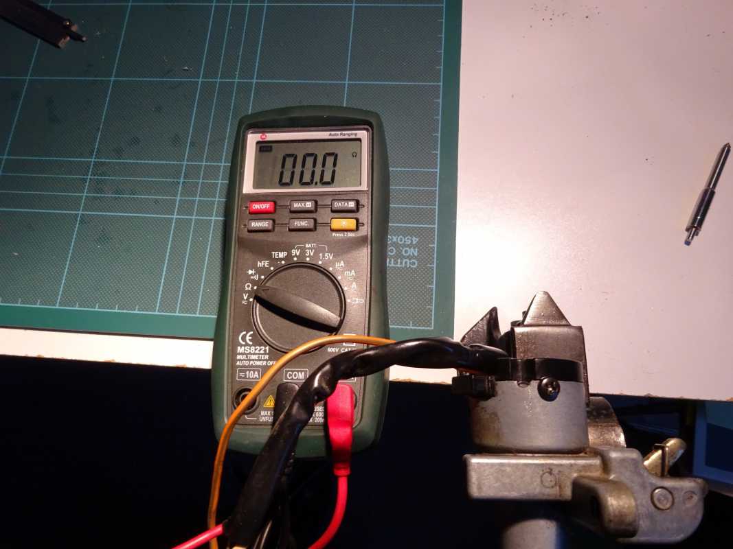

Next step was to clean up the main contact plate with 1200 wet and dry, clean up the rotor arm and the springs/ball bearing and reassembly - reassembly is much easier than disassembly! Switch now showing immeasurable resistance on my digital multimeter.

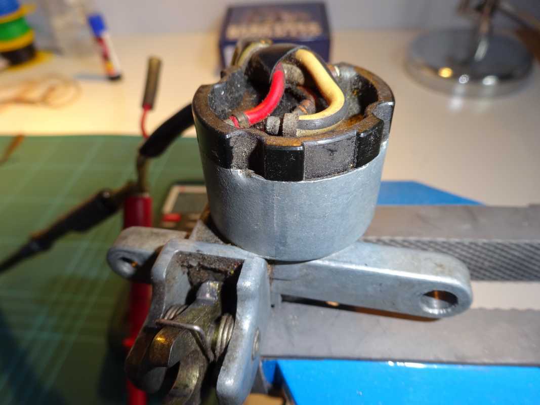

Main Switch: This was showing variable resistance on my multimeter and needed some care and attention - see picture below

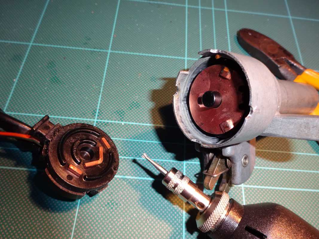

The first challenge in pulling this apart is that it is held together through 4 crimped areas in the metal part of the housing - trying to uncramp these is just not viable as it would break the rather brittle plastic part of the switch.
I used a Dremel type grinding bit to remove the crimped areas and then the plastic parts just pull out.

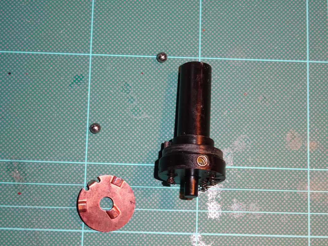

The inner part of the electrical switch includes a rotor arm with two ball bearings that locate the switch in a number of positions - these will spring out and you will lose them if you are not careful when you pull the rotor out.

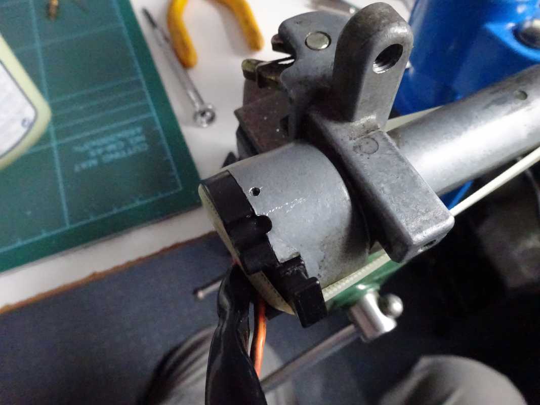

Having ground away the crimped areas, I drilled some holes through the metal housing into the plastic part of the switch and inserted some screw fixings - very important to ensure your screw outer diameter and drilling diameter are pretty close or you will split the plastic housing (I found this out the hard way with my first attempt).

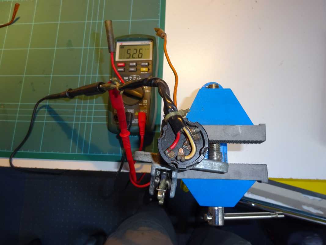

Final pic shows the reassembled switch, screw fixing (I used two, one each side) and resulting resistance measurement
