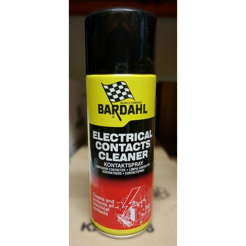

First off, I know this thread is almost 8 years old. Even still I hope everyone's backs are better. Secondly, my start switch is sticking, and sometimes takes several pushes to get any action. I assume the connections are dirty, and It's probably never been cleaned over the last 43 years. If anyone has any tips about cleaning the start button/kill switch controls I'd be mighty appreciative.

Disassemble the controls from both sides of the handlebar in half and spray all parts well with any industrial electrical contact cleaner spray.
Inside the turn signal switch on my motorcycle lived a family of spiders.
