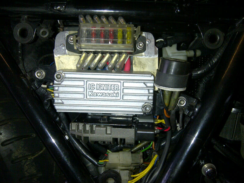

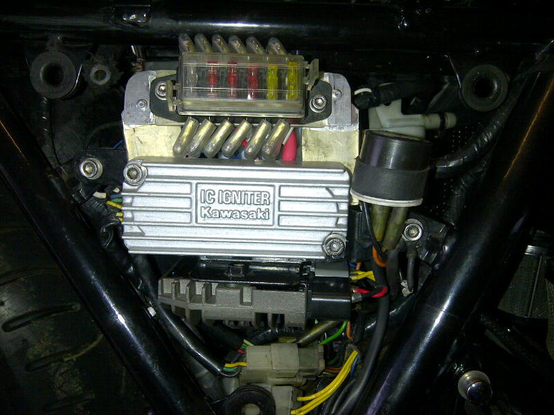

Re: main fuse box under the seat
12 years 6 months ago
Or you could just make a small aluminum mounting plate to fit behind your RH side cover (using the CDI units mounting holes) & fit a newer type Blade Fuse Box like I did below.
I kept the original block connector from the old fuse box too so the new wiring fits directly into the existing loom.
This gives a bit more room under the seat & is tidy.
