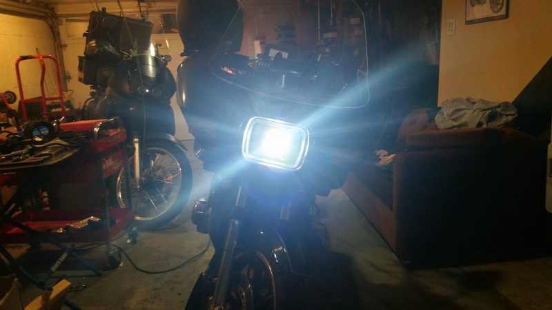

In my quest for better lighting I did this projector mod Picked up the rectangle headlight on Ebay and the projector as well. Did the mod I have to say night time lighting is vastly improved. Thought I would share with the community

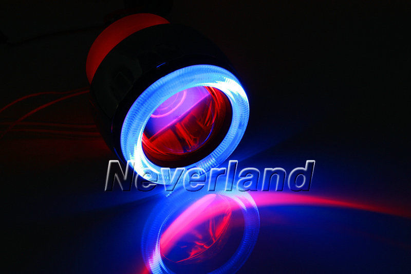

11 years 5 months ago - 11 years 5 months agoWell it's brighter due to it being a HID or high intensity discharge bulb inside the projector housing.The headlight came from a vendor called "tuningsupplier" and the projector beam came from a vendor called "neverland-us". I did the retrofit and when I had it apart I painted the reflector and projector surround with Krylon Fusion Satin black. As far as lighting goes it definitely has improved the light pattern and gives better lighting. It's pretty bright and looks pretty stylish. I have been getting a lot of positive feedback from people just walking by and friends of course. There are tutorials online on how to do a projector retrofit. A lot of the guys driving the ricers you know the slammed Honda's etc. They do this mod for looks. But the safety aspect was more my concern since I do a lot of night riding.

An interesting mod. I like it. To see and be seen is really important. I won't ride without the headlight on. Having a single projector beam coming at you makes you want to ask the question "What IS that?" and knowing that people see the light and ask the question makes me believe "you've been seen" Safety at it's best.
