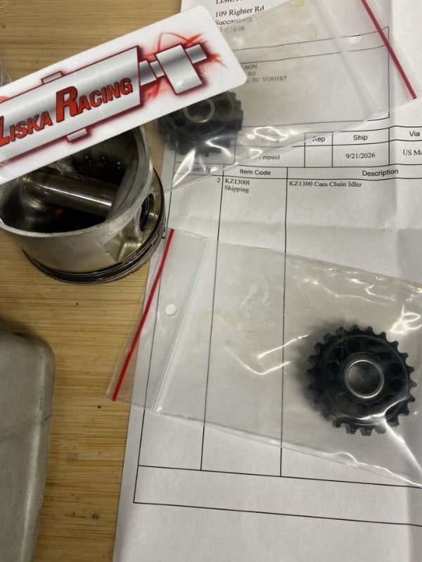

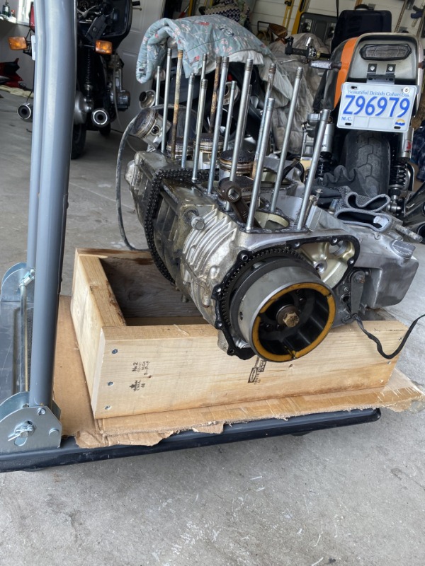

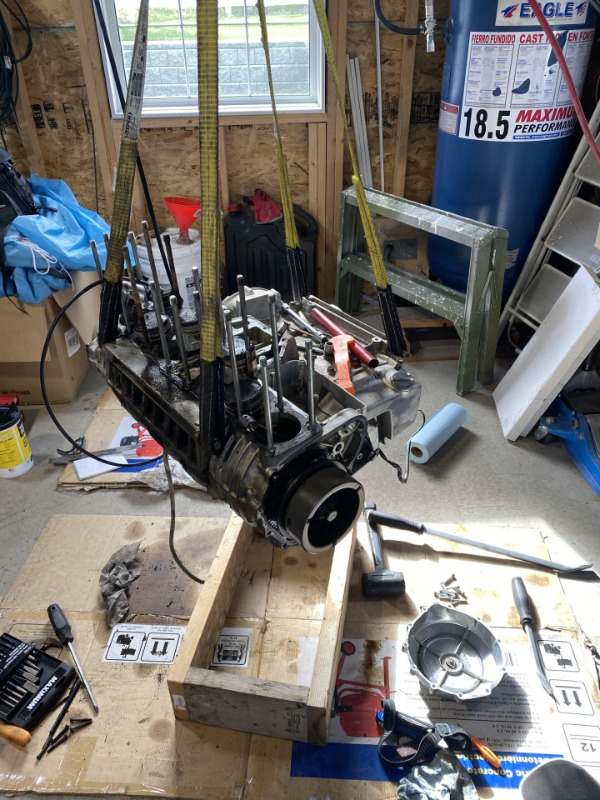

I bought two Liska gears which arrived a couple of days ago and I now have the engine out of the frame and on a dolly for ease of moving around .

Anyway - many things to consider. The first part of the project is to install the gear , install new rings, clean everything up and paint the engine.
