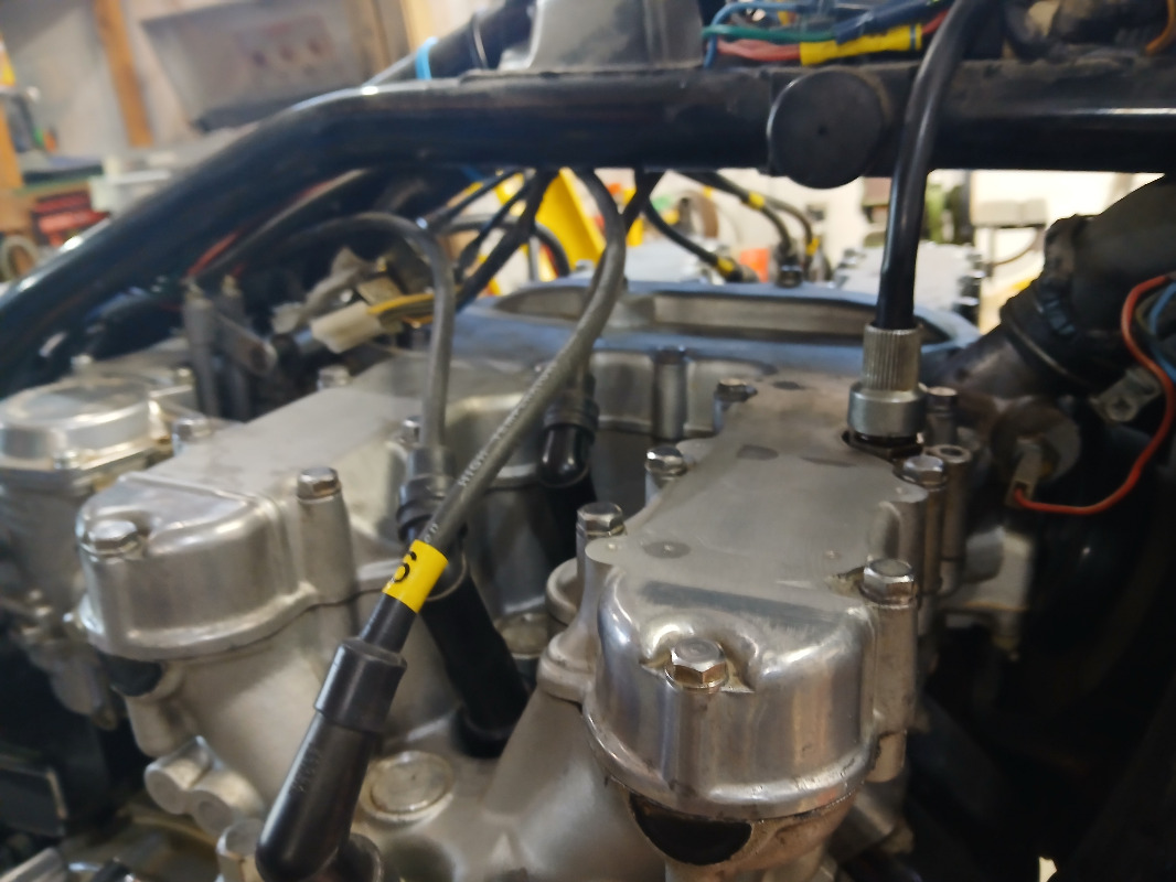

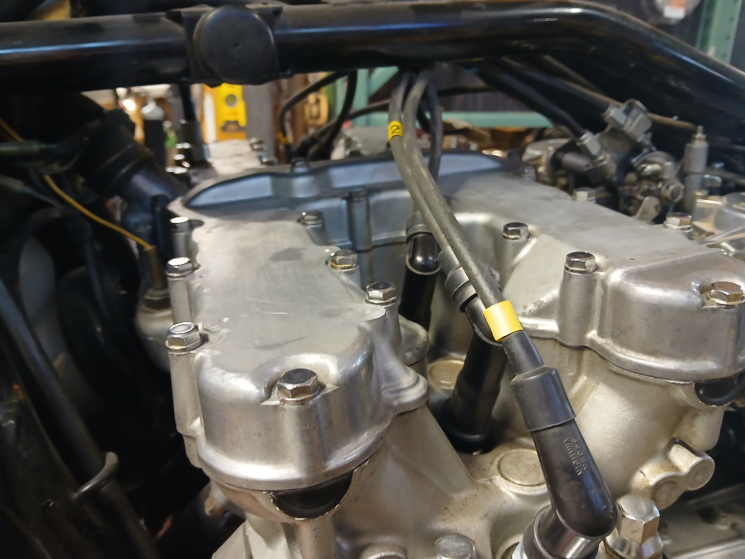

So far I've cut the reed boxes off of my Voyager and my Spectre and now my '81 KZ1300.
Check out the space I have for air flow over the motor. Two of my coils are in the tool tray.:
I've also posted a video of the machining process. To be sure the actual machining was done with all the appropriate guarding. The guarding was removed for clarity.
