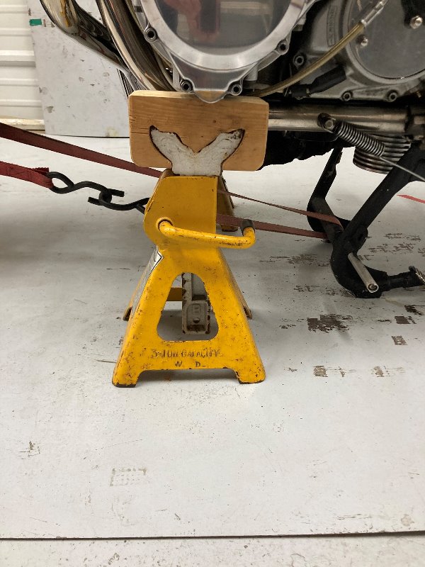

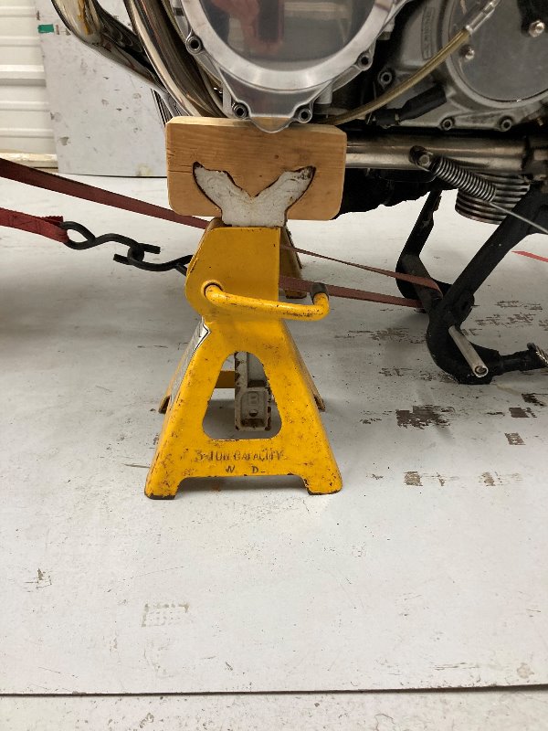

For what it's worth:
and or

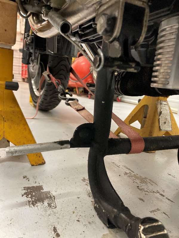

A piece of 4X4 between the centre-stand and the rear wheel works too !

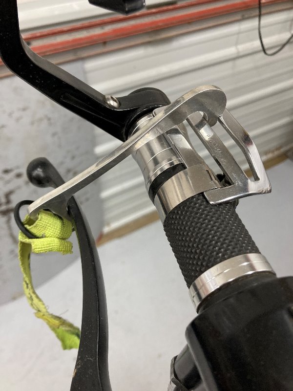

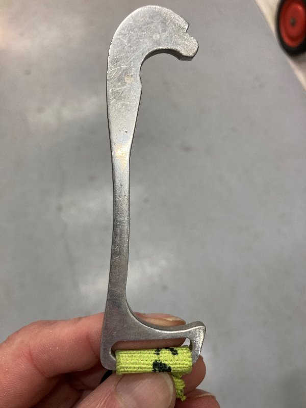

Front Brake lock :

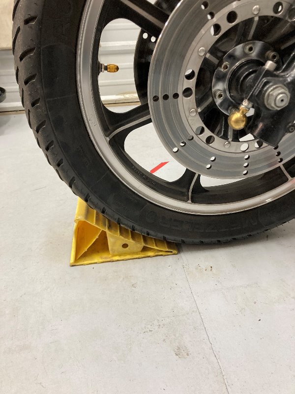

and or
and or
