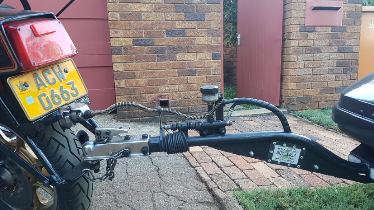

Hello Bill, yes it is the surge brake. Used a second hand Suzuki rear master cylinder. Hitch has a preload spring taken off a 2" single spring mechanical seal etc.

Pic of surge brake

Very nice work Craig! Air Craft quality stuff.

I'm curious about that stop light. I don't remember stock having this small rectangle 'island' up there. What is it? An extra reflector glued on?

Hello Stan. It is a red reflector with adhesive tape attached to the stop light lense. It's law in Zimbabwe to have the extra reflectors fitted.

Got it Craig. :) Thank you.
