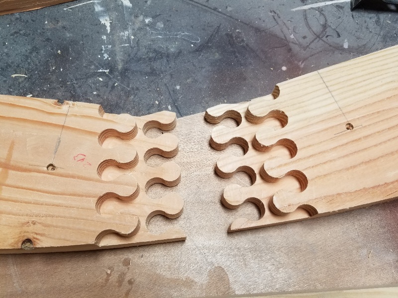

Here's a picture of two boards, one of which must be flipped end for end to be joined.

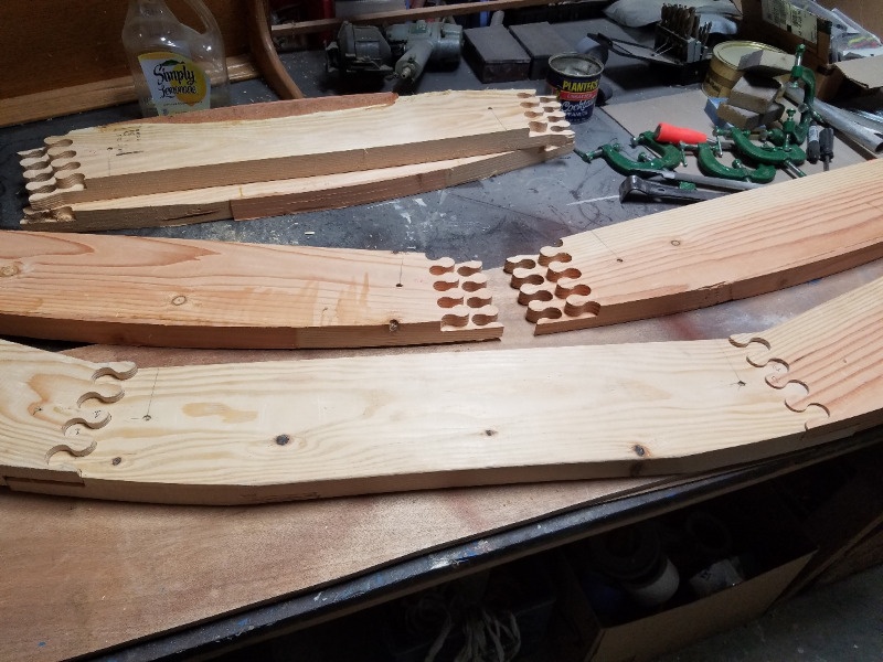

Until now I'd only used bulb joints to make picture frames and various cabinet / fixture types of projects. This fall I decided to venture out into the realm of structural applications by building an 11' by 16' shed that will have a barrel shaped roof. The picture above is of two 2" by 8" pieces of Douglas Fir that will join four other pieces to make one complete arched rafter.
Here are the rafters joined together and stacked on the floor of the shed.

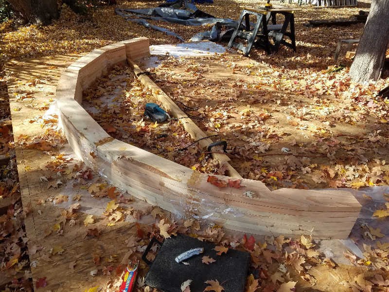

Here's another picture of a few sections joined together on my work bench.

8 years 10 months ago
Hey Bill looks very interesting
always admire those who step outside the box
how are you holding it together laterally ? epoxy glue and clamp / or Screws?
can i ask respectfully would a Dovetail joint lying flat achieve the same result if you stepped it as you have in 2 layers
Dion
Dion
- Posts: 1170
- Thanks: 345
Re: Building another shed for my Kaws.
8 years 10 months ago - 8 years 10 months agoHi Dion,Dion wrote: Hey Bill looks very interesting
Dion
My bulb joint is essentially a dovetail joint so yes if stepped to have male and female sections it would do the same thing. Of course the typical angular, sharp cornered dovetail cannot be achieved with a spinning router bit orientated perpendicular to the work piece.

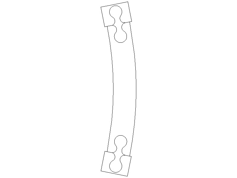

I spent some time deciding on which sort of glue to use and finally settled on Titebond Type III. Franklin Industries typically refuses to approve structural uses of their glues, however they're quick to point out that their glues are fine for structural applications as long as the design is signed by an engineer. For the rafters shown, earlier, I've just glued them. For my "Barge Rafters" (Overhanging Facia on the gable ends.) I'll be using a single bulb that will be glued and bolted. The picture below might be a bit confusing because the boxes on the ends are really just an area to be pocketed out by the router. But this will be how I'm joining the Barge sections. There will be some sort of antiqued bolt going through the center of the bulb.
Sorry if that's too much information.
