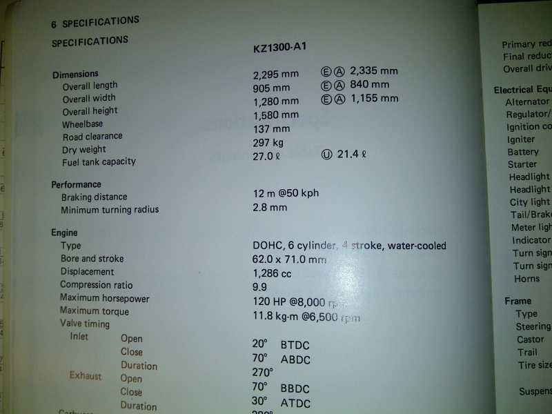

Guys & Experts:
Do I understand correctly that the US version had the small & rectangular (21.4 litre) tank, the Canadian version however had the round version ?
Thanks

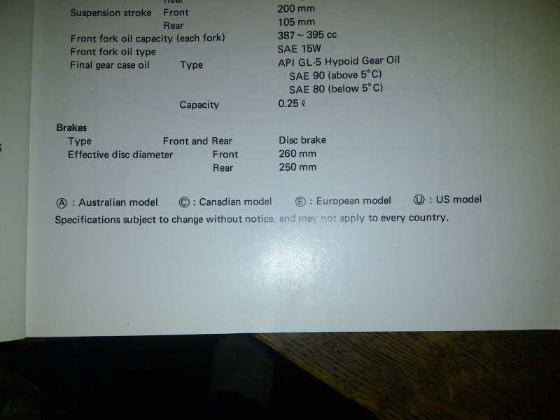

My service manual for the kz1300 A1 has the tank capacity listed as 21.4 L

Thanks for correction. Do you know if your tank is Canadia or US ?

mine is a us model Holger
