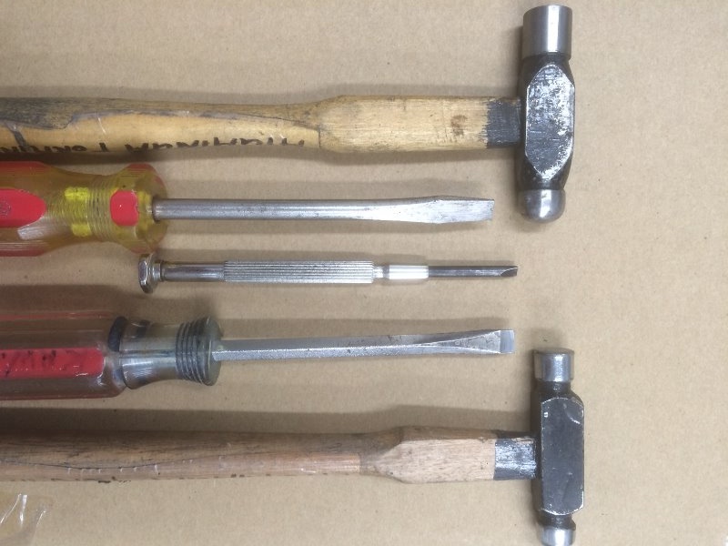

The idle jet screw-driver that works the best for this application is one from an inexpensive set, found just about everywhere. Out of the box, it will be sloppy. The tip needs to be carefully ground (overall length shortened slightly) You'll determine the fit by your own jets and cap. "Used" fittings having a (slight) taper to the slot will require a slightly different "grind" as opposed to New parts which will have perfectly parallel slots. Because the idle-jet cap and the main-jet are external, I am not adverse to fitting the driver "home" with a VERY LIGHT TAP. This will place the driver end fully to the bottom of the slot as well as to the sides. If the driver doesn't fully engage and go completely to the bottom of the slot with a LIGHT TAP, then re-work the driver end a bit more. Common sense has to prevail here! Don't use a 3lb ball-peen ! I use a miniature ball-peen hammer to accomplish this without fear of breaking a slot-ear off.

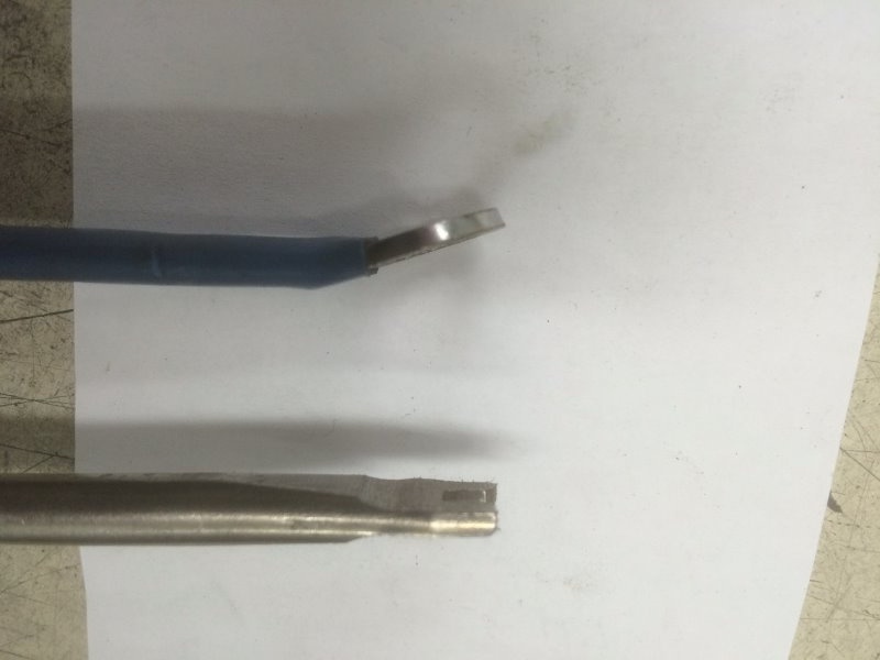

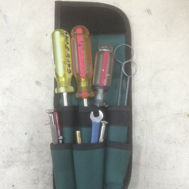

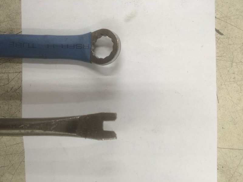

I have a dedicated set of tools for the carbs. The "Notched" driver and small box-end wrench are for the sync. adjustments. The box-end was ground thinner to match the thickness of the lock-nut. The slot in the screw-driver matches the 1/8" (equivalent) head of the sync. adjustment stud. I've tried other ways but for myself these two tools make sync'ing very easy and consistent.
