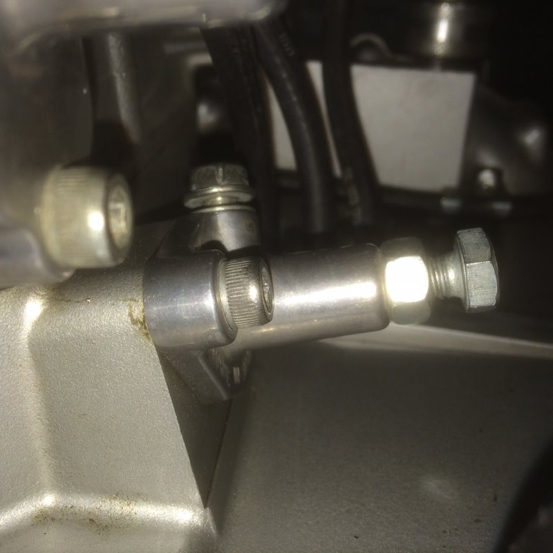

You mention that your chosen method of dealing with the cam chain tensioner problem was to fit a set screw into the end of the tensioner housing. As you say, there is not much thickness of metal there. In my case, I intend doing what Lare did to his - fit a longer set screw with locking. nut in place of the existing hex head side mounted push rod retaining screw. This prevents any chance of the push rod making unwanted movements, whilst retaining the correct tensioner spring. It be comes - in effect - a manual tensioner, but without the possibility of over or under tightening the chain. Of course, you know all this, but it might be another option for our new owner to consider.
Ahh! I would be interested to know more about this ... sound fairly simple. I have looked at where the hex head screw is at in the center of the tensioner. So that one comes out, then what length of bolt goes in its place? Or do you just get a longer bolt of the same pitch and turn it by hand until it seats, then use a lock nut on it?

The photo should help qualify the mod to the OEM tensioner. What can't be seen is the "Internal" nut that's immediately opposite the exterior lock-nut. The internal nut was "rounded" to fit snuggly in the very end of the bore in the tail-piece of the adjuster. There's more, but I'm not going to complicate this further, at this point. Hope this helps somewhat.
