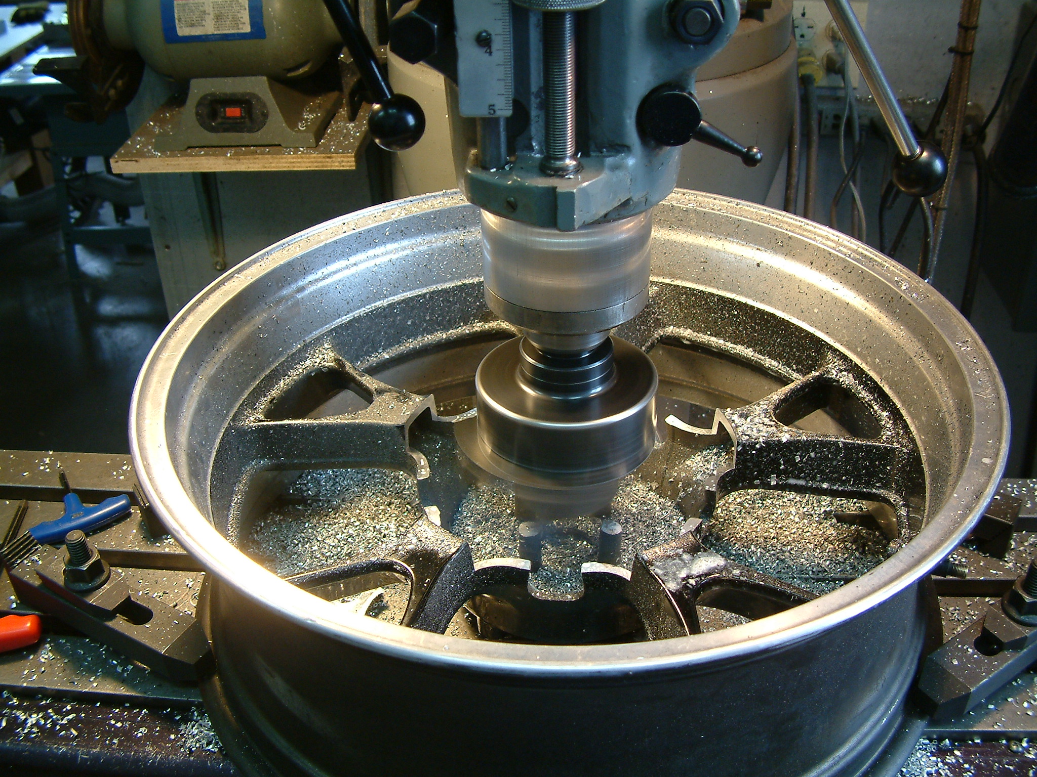

I tackelhappy
I used the original center of KZ1300 1982 The wheel come from a ZX14 and I removed the center and cut the left side of an inch machined and welded the two pieces together. Both wheels are machined and welded together. All welds were made with a TIG. The wheel turns strait.
