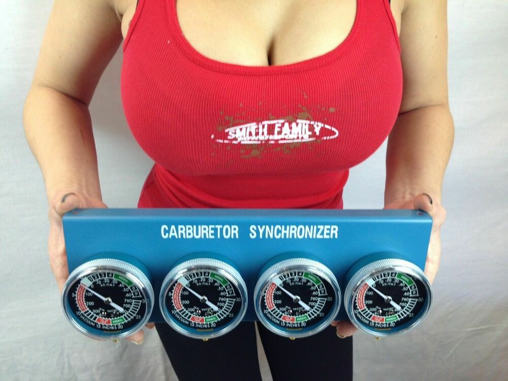

If you're using something more common like these gauges, Note they are calibrated in "Inches/HG"
A problem (and confusion) can arise (for the uninitiated) if you're using "Inches/Hg" (8"/Hg is good !)
but trying to achieve a cm/Hg (higher #) reading.
8" Hg = 20.32 cm" Hg
1" Hg = 2.54 centimeters Hg

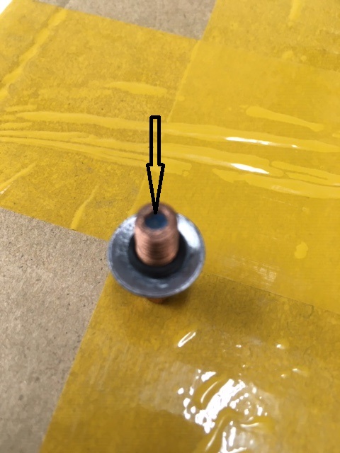

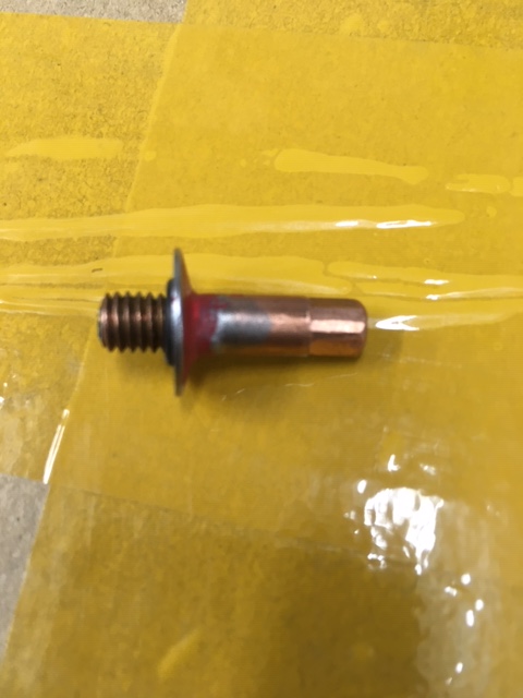

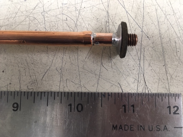

I use MIG welding tips (wire size irrelevant) as manifold vacuum adapters. Drilled-out the threaded end and packed cotton into it to dampen the pulses.

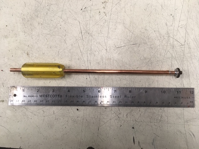

A simple extension for the center carb. A screw-driver handle drilled out and epoxied to the extension.
