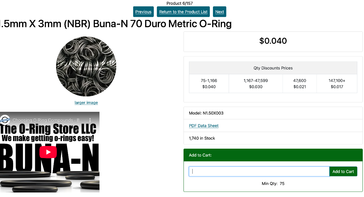

Well, the price is right!
Might have to buy a bunch more carb racks to use up 75 o-rings though? (min order)
