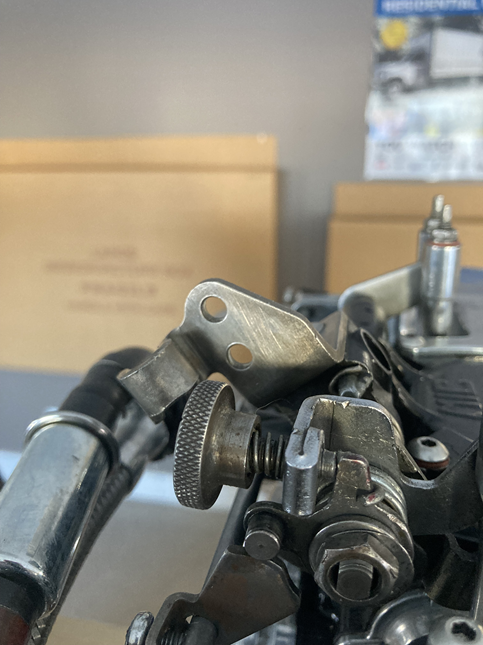

1 year 8 months agoKawaBCN, if not too much trouble, can you check to see if the throttle plate is contacting the mechanical stop when butterflies are closed? See my post below.... If so, please take a pic of the various mechanisms so I can see the relationships between Idle Adjust, Fast Idle Adjust, and Butterfly positions?

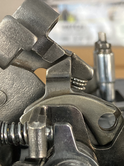

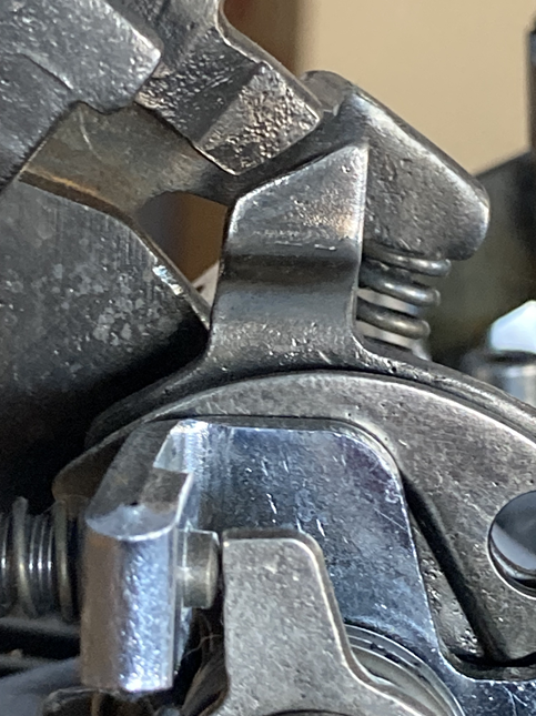

Think I found out true reason why Throttle Stop not contacting Cable Assembly...
Thoughts? Comments?
Thoughts? Comments?
- Posts: 1316
- Thanks: 304
Re: 2025-02-11 Throttle Stop Not Adjustable? (Carb Pivot Point why?)
1 year 8 months ago
In conclusion... don't worry about this adjustment seems to be common consensus?
