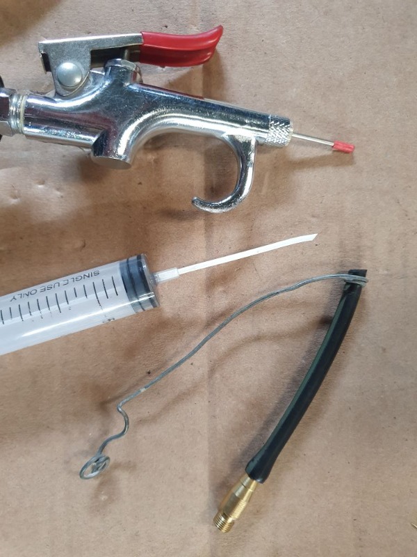

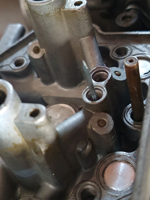

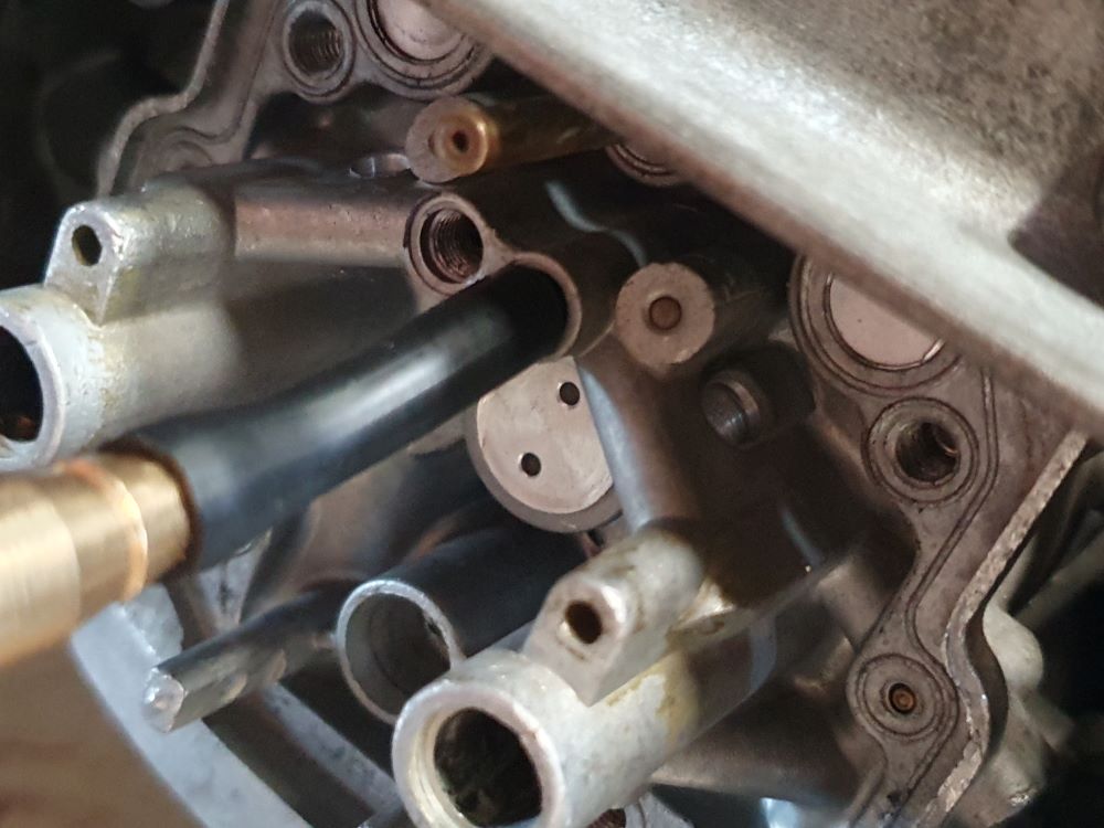

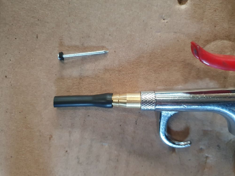

Owe you guys an update. Not sure the soaking for 20 minutes would do the job as I have squirted laquer in every few minutes for a couple of hours, then blasted with air. Rinse and repeat multiple times but no joy. Reference first photo below. The narrow plastic nozzle off a CRC can fitted nicely into the syringe and then tappered the other end to be flush with the idle passage exit in the emulsion tower. Used the football inflater attachment for the air compressor, a little electrical insulation on the tip to close off the side opening and fitted pretty snug against the idle fuel passage opening. This worked, eventually, on one blocked passage on #1 carb but wasn't making any progress on the second blocked passage on #2 carb. Then the repeated advice of wiser men kept echoing in my mind - flush in opposite direction of flow. So pondered on how to block off the bottom of the idle screw cavity. It ain't pretty (second photo) but got a small rubber plug (out of my hole punch for leather/rubber) that was a friction fit in the idle screw hole, tapped a small flat headed brad through so I could get the plug out later, easd it carefully into the idle screw cavity with brad sticking out. Then placed air compressor with rubber hose attachment over the brad and held it over the idle screw opening. One puff and it blew clear. Afterwards I thought I should have put a dab of liquid insulator on the head of the brad, to avoid potential damage to the idle screw seat, will do that for next time. Super easy and should have done it from the getgo. Hope it helps someone else.

Adaboy . Nicely done !! Now we have you thinking like a carb technician. Once you understand the flow of fuel / air through the carburetor, you can do your testing to figure out where the problem is and then come up with a way to fix the problem.
I'm not surprised that the passage going through the emulsion tube was blocked since it sits in the gas that is in the float bowl and as the gas evaporates or deteriorates, varnish would form. Now normally, those particles of varnish would want to flow down the path and then get stuck at the transition ports but in your case, I guess the varnish had time to build up and get stuck in the passage in the emulsion tube and you figured that out and came up with a way to clear that part of the circuit independently. Good for you !!
Thanks for sharing. I'm sure it will help out those that follow the writings here.
