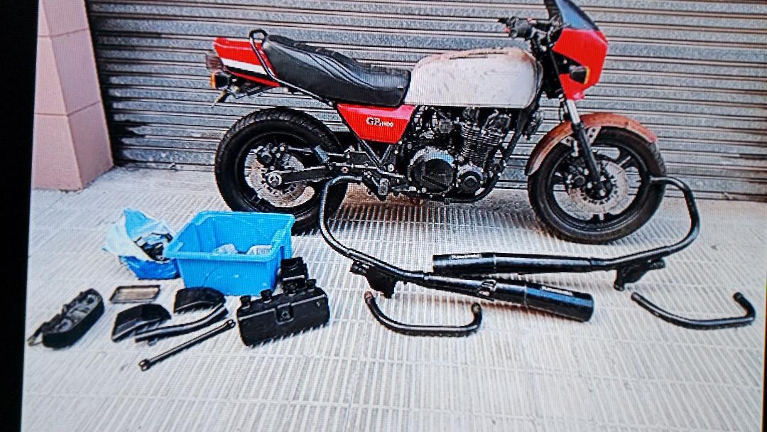

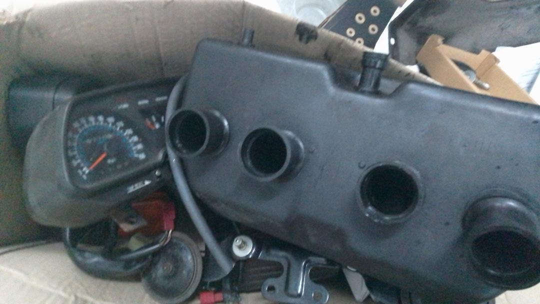

This summer I bought a “Project” racing bike based on a GPZ 1100.I already own one painted in ELR colors so I basically acquired a nice aftermarket set for my bike.
The story is as follows, a guy bought a lot of 8 Kawas in Holland, there were several models, including one of the Police.
I had this ad for months until I was able to buy the bike for 800 euros, it was just 100 km. from home and I did not let him escape.
The chassis has Dutch title so here in Spain is almost impossible to legalize it, hence its price.
The chassis numbering corresponds to the model KZ1000 J. '82.
Checked the numbering of the engine is identical to mine.
When I got home I hurried to disassemble the bike and put it in boxes because my wife would not accept another bike in my garage, no matter how many technical explanations I could give her.
First surprise, the ENGINE HAS JUST BEEN REBUILT.
Pistons, valves, crankshaft, all brand new.
It had not yet been run in, the engine was ready to be oiled and started.
I have all, fairing, tail, side covers, and more electric parts.

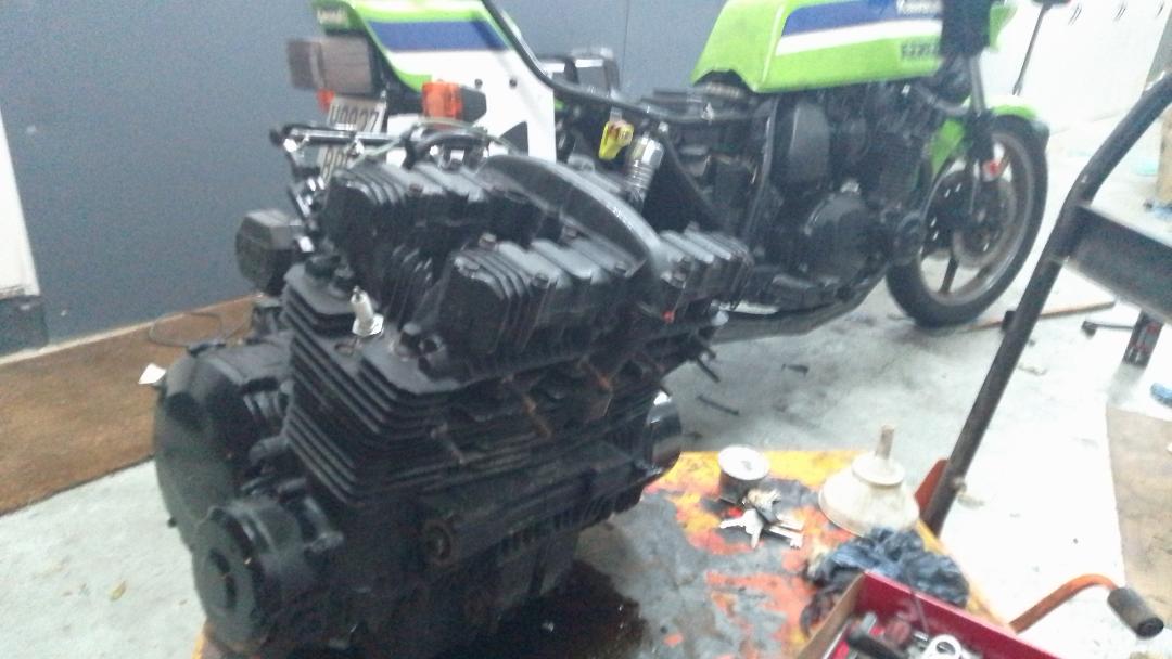

Well, this weekend I had the bright idea to change the engine on my ELR, when the intention is good, what can go wrong?
So Saturday after lunch I took my wife's car out of the garage, my little workshop is occupied by partially disassembled Christine, and got down to work.
I was able to get the engine out by pulling the bike to the ground, I couldn't use my ternal of lifting loads as it is anchored right on top of Christine.
I convinced my two sons to come down just before dinner to give me a hand to put the new engine in place, we all directed the operation although I was the one who made the most effort holding the engine in the air.
Just before their mother called us to dinner we had it in place on the frame.

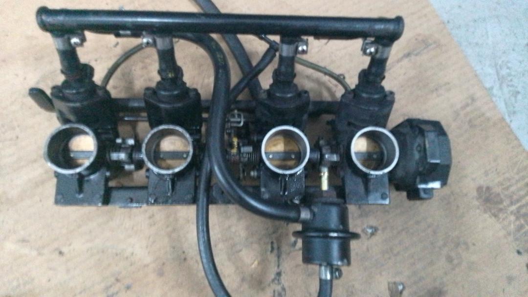

After dinner I went downstairs to continue with my work, first I placed the injectors battery previously cleaned, the airbox and the wiring of the alternator and ignitor.

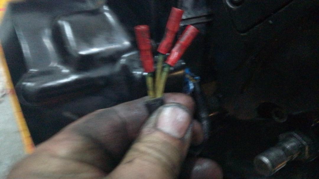

The three wires coming out of the alternator on both engines are the same color, they don't seem to have a specific order.
I changed the coil wires, it was two in the morning when I finished mounting the exhaust, took a shower and went to sleep.

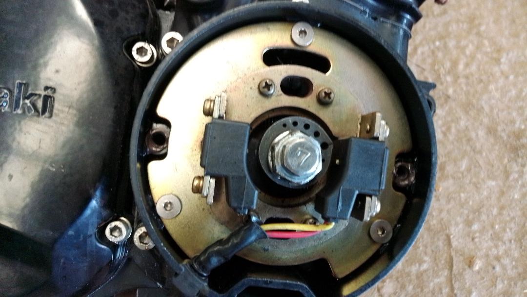

Just as on the 1300 you have a point to adjust the electronic ignition on the GPZ I could not find it, it seems that the ignition pads have a fixed position, it does not allow adjustments in its advance.
There is good spark on all spark plugs anyway.

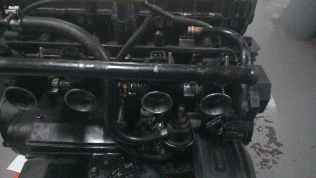

In an attempt to drain the injection system to disassemble it again, I close the fuel inlet valve, just when the fuel in the circuit was running out THE ENGINE STARTS TO RUN WITH ITS FOUR CYLINDERS.
I open the valve again to let the engine turn at 2 or 3000 RPM and it dies again.
Another attempt, I close the fuel and the engine ends up starting, I open it again and the engine stops after losing cylinders 3 and 4.

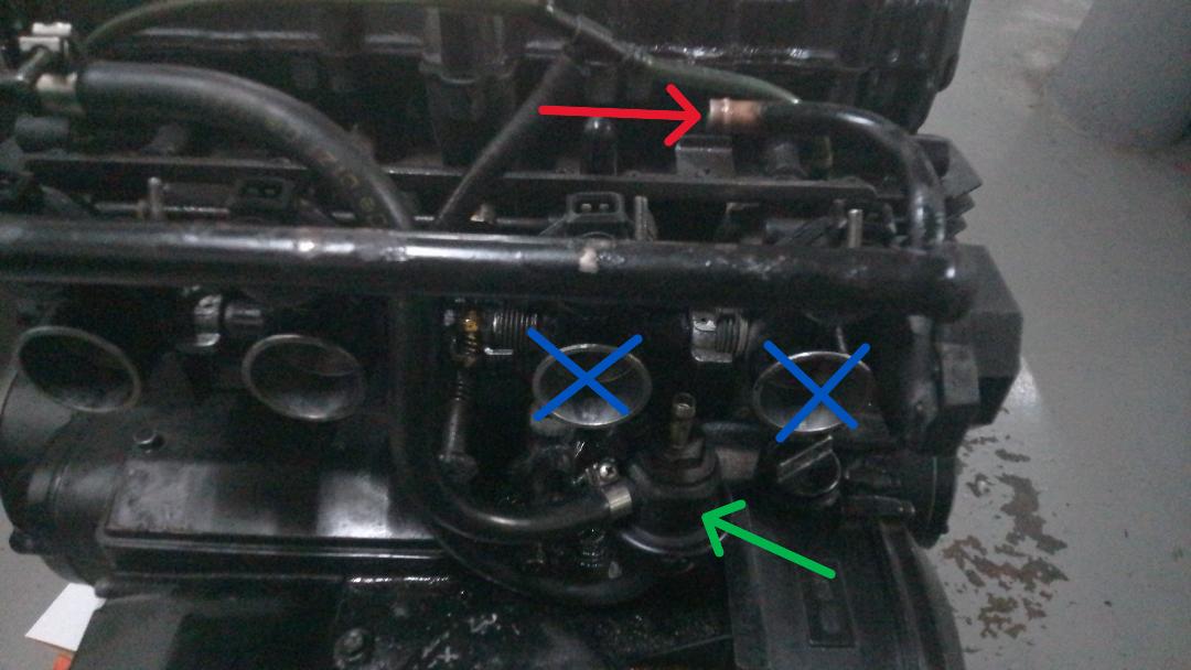

The fuel enters through the red arrow tube, it seems that there is an excess of pressure that cancels out cylinders three and four, while cylinders one and two work.
THE PROBLEM CONTINUES WITH THE TWO BATTERIES OF INJECTORS.
The pressure relief valve (green arrow) appears to be working.
The DFI is also working.

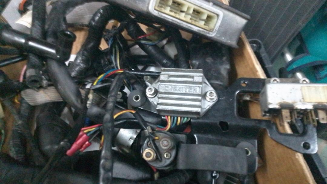

I had planned to change the position of the cables but I was late and I didn't have time to carry out the test, although with the tester I read the same number of ohms in all the injectors.
In case they fail I will change the wiring, I have a replacement but first I have to condition it, basically hairdressing and beautician since it hurts my eyes when I look at it.

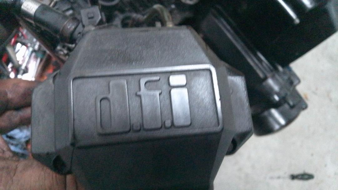

Each DFI is attached to its injector body, I have not touched it for fear of worsening the situation.
The failure symptoms are the same in each set.

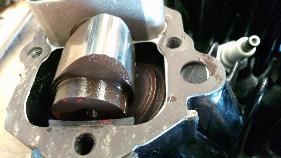

I disassemble the valve cover and check the valve adjustment.
Cylinder one and two are almost perfect, I have to change a shim of a lower numbering to give a little more tolerance.
In cylinders three and four the intake valves are stuck, they do not close and the compression escapes.
Using the shims I had saved from when I adjusted the Z13 I can finish the adjustment.
I check the compression again and cylinder three gives me a reading like one and two, cylinder four is still dead.
I pour some SAE 90 oil into the cylinder to check the compression again, it was not the case that the piston rings were broken, it still gives ZERO compression. With the intake valve closed I spray some VD40 through the intake duct and I see how the cylinder fills, the valve does not close although the adjustment is ok.

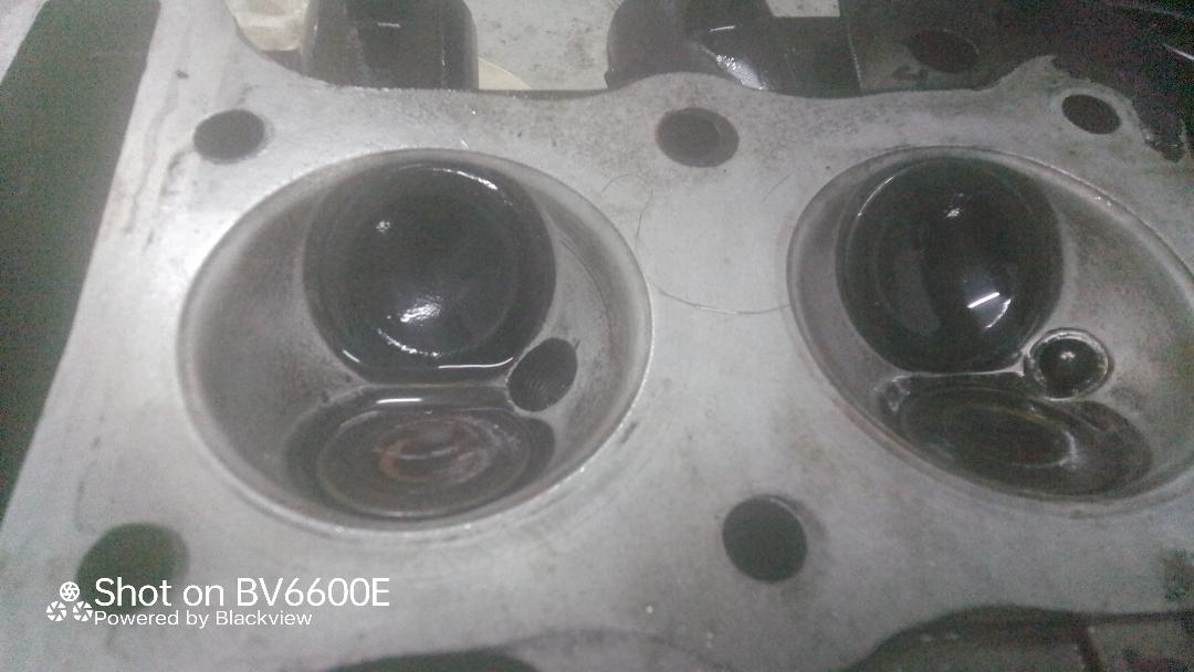

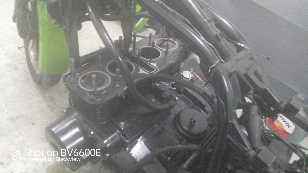

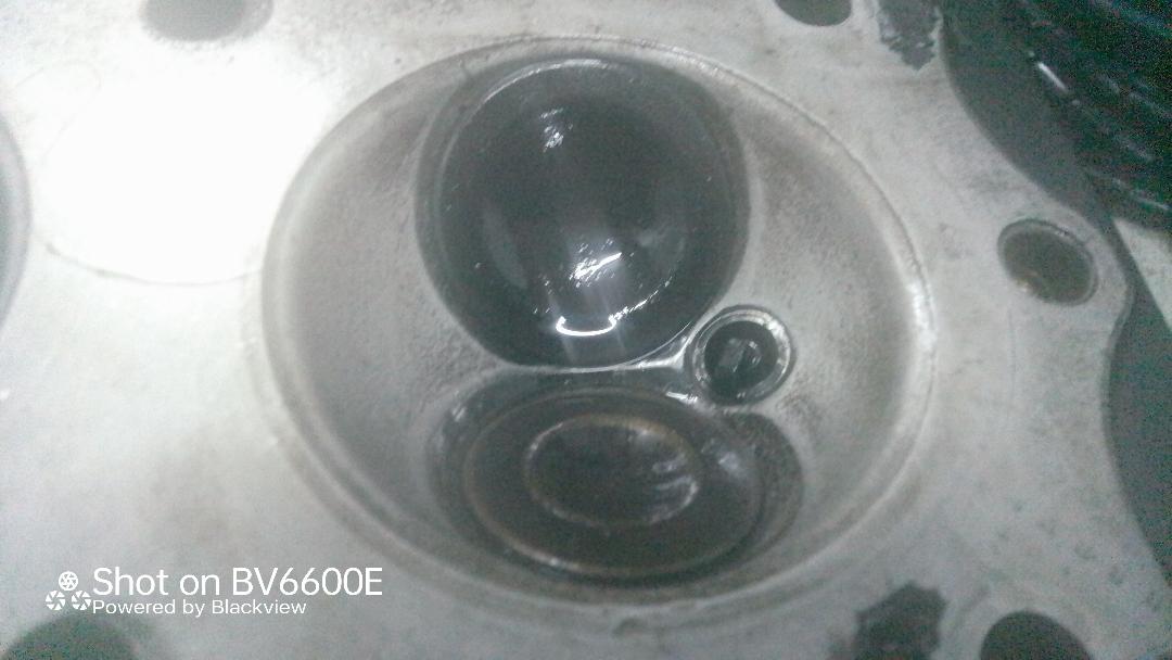

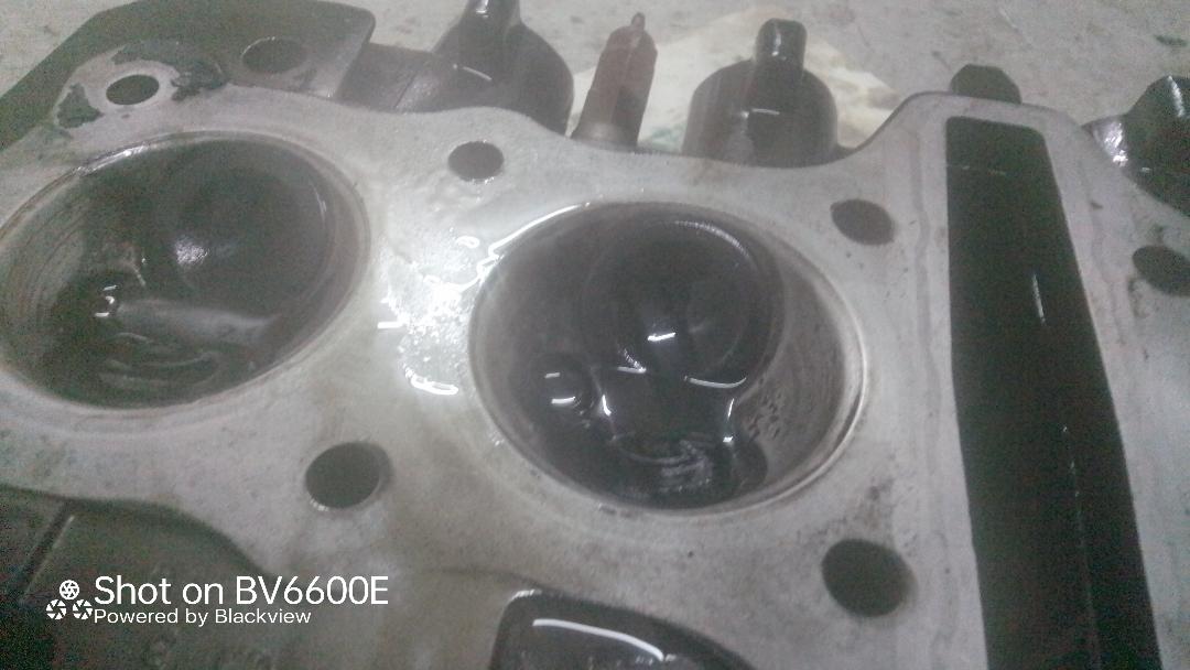

I have disassembled the cylinder head.
Valves on cylinders one, two and three are watertight, retaining WD40.
The intake valve of cylinder four does not close completely, after pouring VD40 it is drier than a one-eyed man's eye.
I don't know if the person who mounted this engine at the time checked the valve settings, in fact the engine was mounted on the bike but far from being ready to run.
Next week I will be taking the cylinder head of the engine in for repair, it will simply be a rework of the valve housings, I am looking forward to getting back to riding the bike and stop listening to my wife on this subject.
