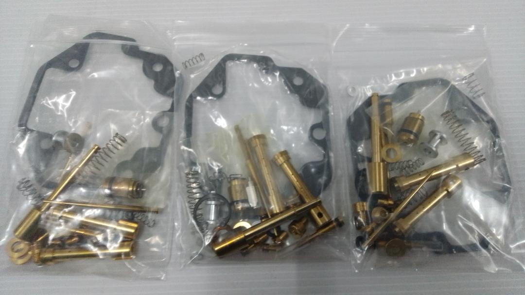

I ended up buying a repair kit, it didn't cost me much money.
DAMINEDING KIT

These kits appear to the "generics" sold on EBay and if they're the ones stated as being made in Taiwan, you're good to go ! I've been using them for years in many carb-sets I have rebuilt and they are GOOD !
Although ''79 carb rebuild" article is outdated in some details the premise is clear. CLEAN, CLEAN, CLEAN !
