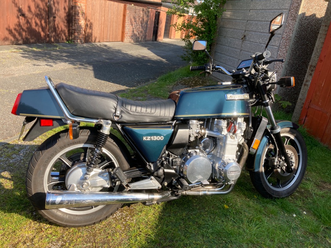

Well finally she’s running properly, bolted the carbs back on and after a bit of balancing she runs as sweet as a nut. The tickover is a bit fast and the adjuster is fully backed off so I think I need to redo the balancing.
Thanks to everyone for their input, hopefully i can just enjoy riding the beast now.
