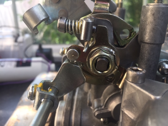

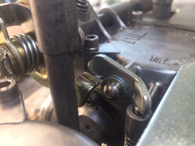

6 years 3 months ago - 6 years 3 months agoHi, I set it all up and took the carbs onto the bench. I adjusted the fast idle as best I could without it being on the bike. Then I went to follow Scotch's instructions as per above link.
I failed at the first hurdle.... I did the paper strip test on the LH carb and I could not set the adjustment so that the paper was unstuck. Adjustment screw all the way in made the mechanism bind and still the gap was too small to get a piece of folded paper through... The other two were fine... I could set it as described, paper moved with a slight drag.
I now also have massive gaps where there were none before...one on the choke valve between the roller and the tab, and one at the idle adjusting screw…See pics.
