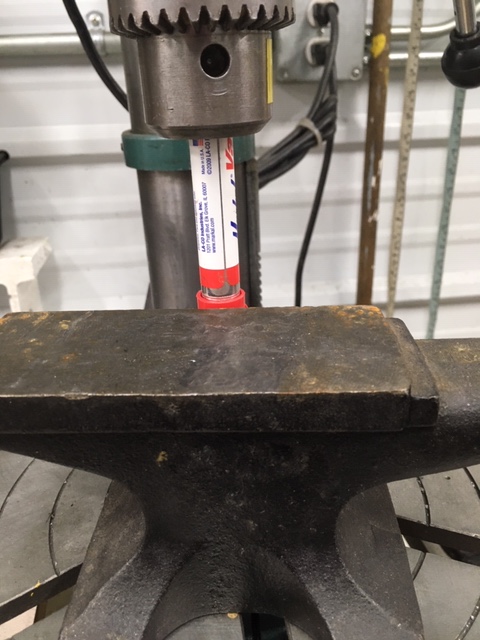

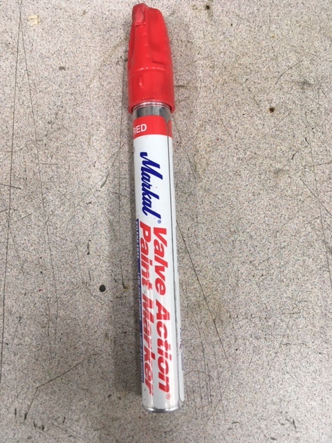

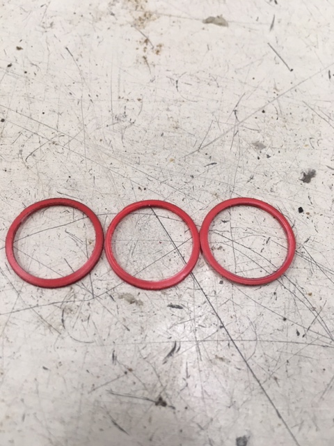

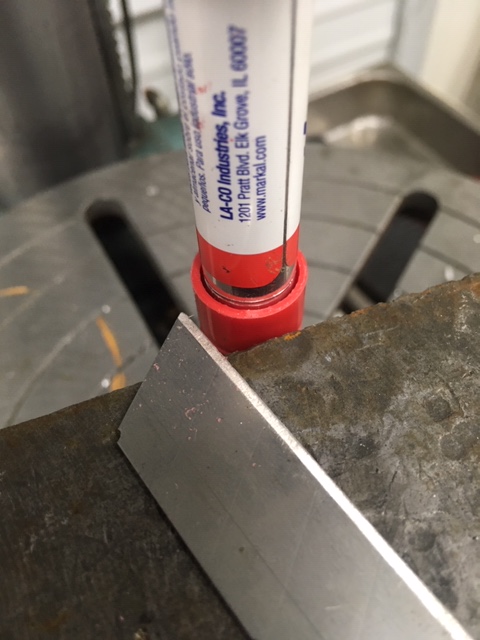

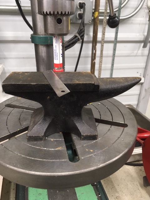

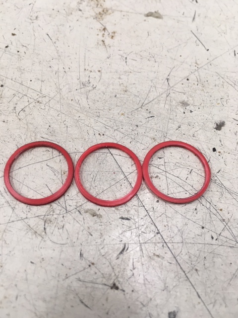

RE: The spacers (3) for the diaphragms.
These are almost impossible to find. None-the-less.....: Was using a marker this a.m. and had this brain-fart. The pictures should be self explanatory. I managed to get three parted-off; within several thou. which is close enough.

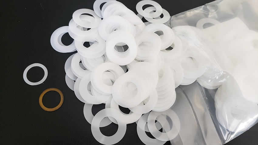

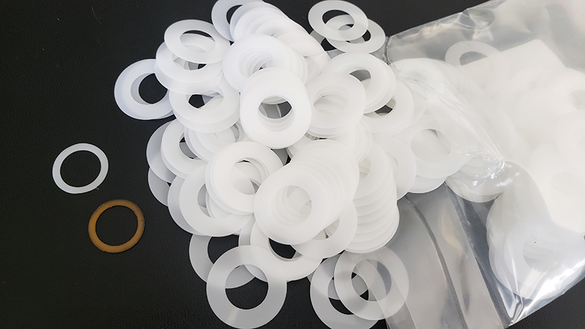

As to the carburetor washers, it might be as simple as asking me. They are the exact stock inside diameter and thickness, and from the correct material. I can cut the outside diameter for you, or anyone handy with scissors - diy. 0ne thing for sure, I won't run out of them. Made in Japan.
Last edit: 6 years 7 months ago by StanG.
Re: butterfly screws stuck, washers for diaphragm.
PS.
Washers BY D0NATI0N . Shipping by location. PM me.
