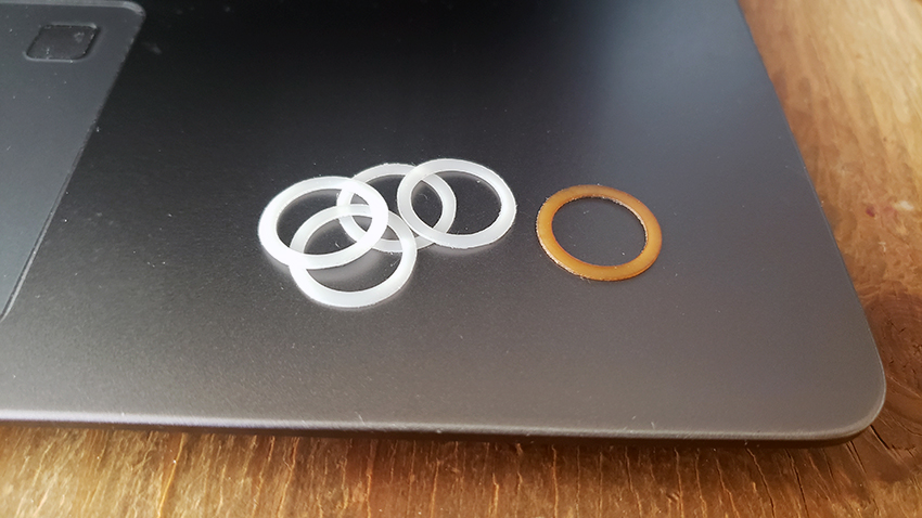

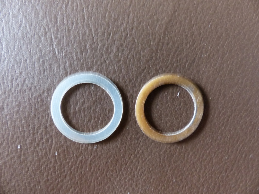

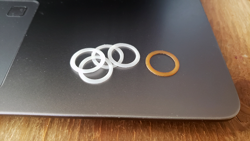

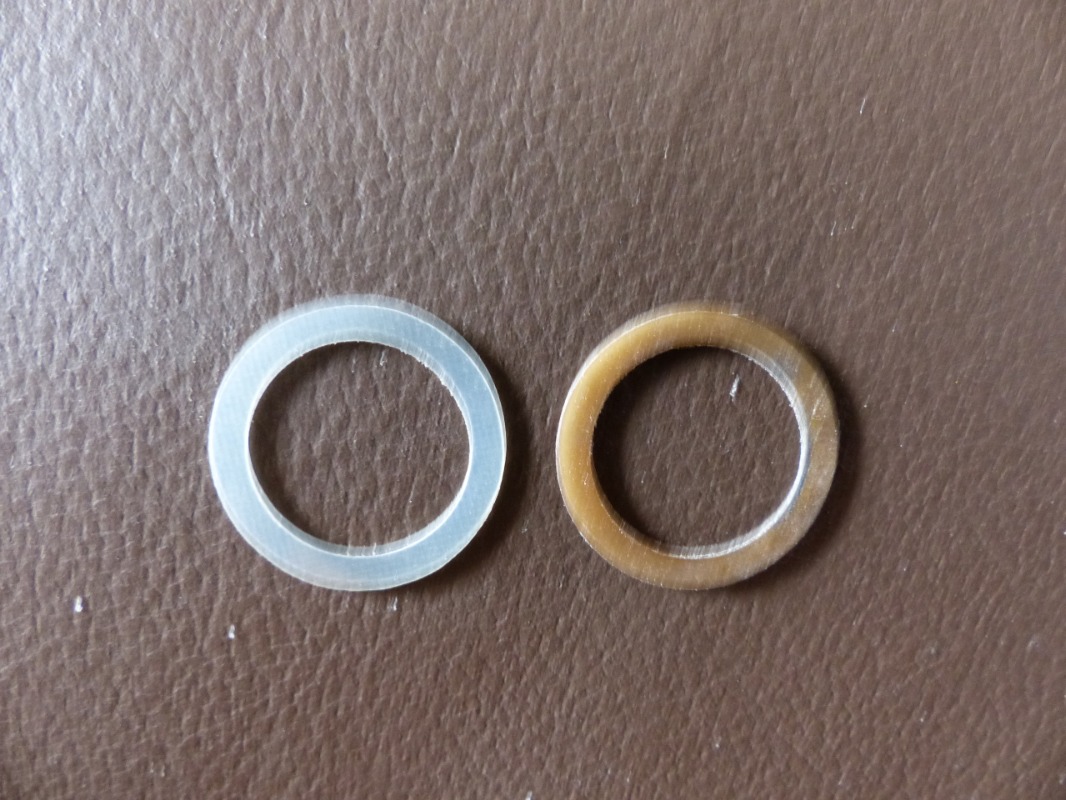

Tad - they are ready
I will follow up tomorrow with shipping costs in the PM.
Stock on the right for reference.
The original stock Kawasaki washer is actually plain Derlin as well. I remember seeing some in the past that I also thought had some sort of cloth inside them. I'm not sure if that was an illusion, but this one doesn't. Perhaps different years had slightly different washers if that was the case. Bottom line is it's plain Derlin, and the new replacements I offer are plain Derlin as well. The stock washers are most likely discolored brown due to age and fuel exposure.

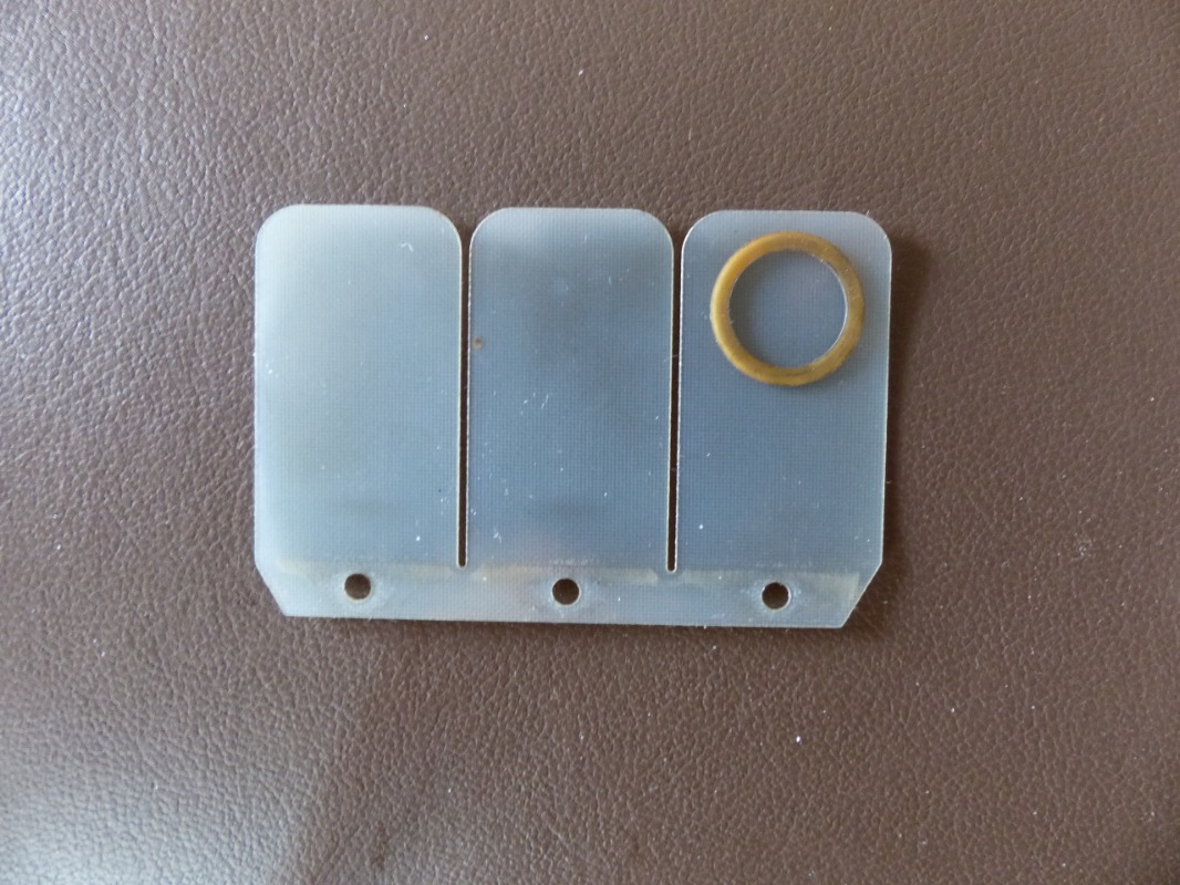

Look familiar?
I had a missing washer and fabricated one from a reed valve kicking around.
I know someone on the site had lost one and I made him up one and sent it to him. Maybe it was you Stan?
