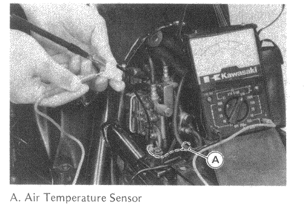

hi phil ,,dont know the model ,,how can i tell ,, this is a trike ,,the wiring and stuff is a bit mixed up ,,

oldmanpepsi wrote: hi Kawboy ,,,thanks for the reply ,,,,i dont know which model i have ,,have ,,this is a trike which i have just bought as a project ,,how can i tell which model it is ,,also ,were is the air sensor ,,what does it look like ,, were can i get a workshop manual ,, i see different ones online ,,,,as i dont know the model i dont know if i buying the correct one

As far as the manual goes, there is an electronic copy of the ZN Manual on the Home page of this site available to members for downloading.
See pic for location. The manual doesn't say where it is, just the pic. The wiring feeding the sensor is 1 blue wire with red stripe and 1 blue wire.

On the ZG the air temp sensor is attached to the side of the airbox, so I would imagine it would be the same with the ZN Voyager.
