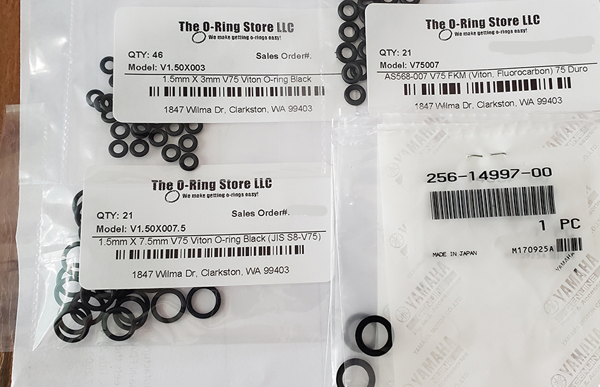

Just so you guys know exactly.

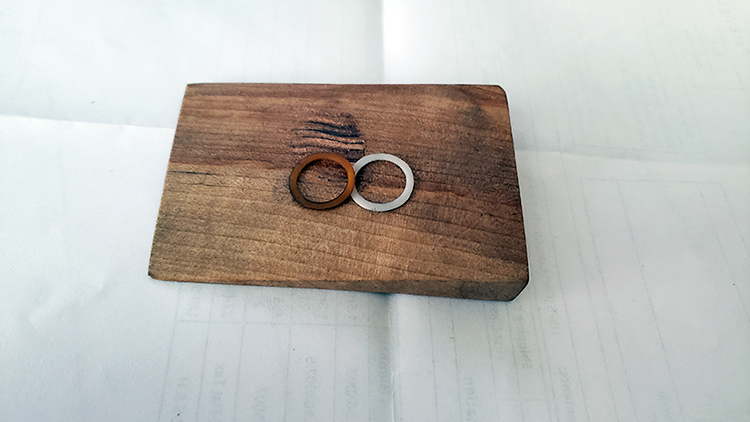

Missing these thin duracon washers (92022 - 1155) or damaged? I will have them (left: old, right: new)

Have you had those washers specially made, Stan?

Yes and no. They are perfect size except the outer diameter, which I cut with a scissors to the correct size. What I need is to find someone local with lathe, make a 'bolt' to keep a bunch together, and machine the outer diameter at once. A very straight forward thing. If you just make a set of three it takes a few minutes and inconvenient, and I wasted a couple, but not a big deal. I just cut what I need and the rest is waiting for that lathe. 0r if I find a proper bolt from the get go, I will try doing it using my drill and a woodworking chisel.

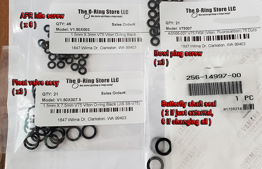

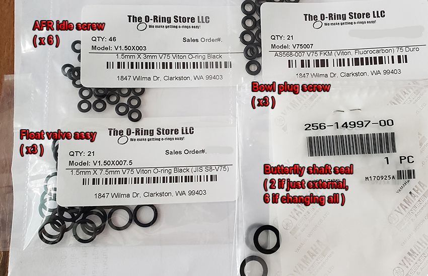

StanG wrote: Just so you guys know exactly.
Any chance this image could be edited to detail where each size is used?
