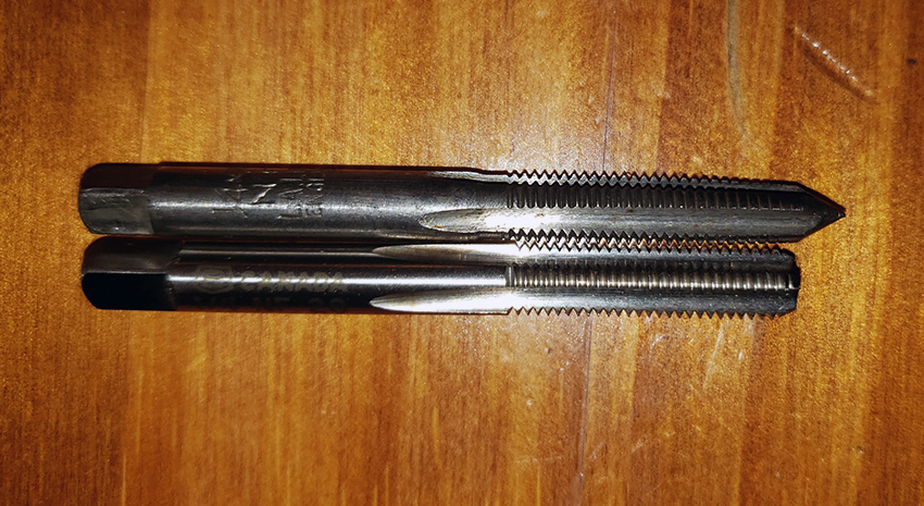

I've been looking and can't find 1/4 x 32 metric equivalent. In fact, can't find 1/4 x 32 at all. All reference tables I found so far show 1/4 x 20 and 1/4 x 28.
In the meantime, I just too a quick show and tell photo of two NF 1/4 x 28 I have. Quite different, aren't they?
Top marked England, bottom Canada.

Just my point of view but I would think that the way to go if you were going to tap the carb would be a standard M6 thread. The hole cast into the carb is very close to the tapping size of the M6 (5.1mm), so no drilling required. The tapping size for the 1/4" is 5.4mm so you may need to open the hole out to get the 1/4" tap to start. Standard 1/4" UNF is 28 TPI, although 20 and 32 TPI taps are available.
If you did need to drill the casting the drill is prone to snatch with the drill size being so close to the cast hole size, even if you "dulled" the end of the drill. Also you also have to align the drill with the casting hole which isn't easy by hand, especially if it does snatch. If you made a mess of the drilling you would then have to go down the thread repair routes
I would defiantly steer clear of having to drill the carb, especially if you don't need to as the metric size will tap without opening the hole up.

- 1/4 x 32" tap, what is the actual correct corresponding tap size - in metric?
There is no "corresponding" metric tap size. 1/4" x 32 UNEF is a standard size. UNEF threads are more likely used for adjustment screws where a fine pitch is required more than grip strength. In this case, I think Holley may have used the 32 tpi thread to force you to buy their jets down the road if you needed replacement jets. Brand loyalty so to speak.
If finding the 1/4" x 32 tap is a problem, then you could go with the Mikuni B42-55 jet in size #240. ( which is .094") www.jetsrus.com/a_jets_by_carburetor_typ...kuni_B42_55_air.html
This jet requires a M6 x 1mm tap which is a common tap size and not a specialty size.
