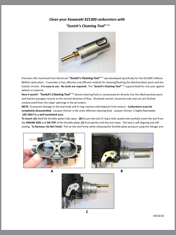

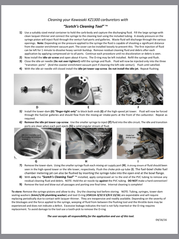

All these bikes seem to run fine with the needle set in the middle notch so I wouldn't try raising the needle. I Don't think that would correct the issue. The velocity of the air flowing down the venturi is still too low to pull fuel up the mains below 2000 rpm.

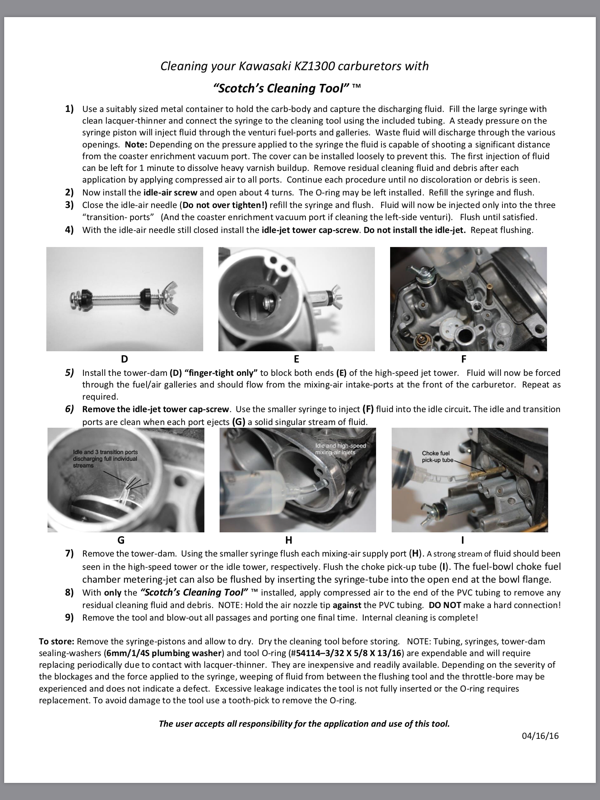

All of these bikes struggle with the transition ports being blocked if they have sat for a while. The only way to clear them that's been effective is to flush them in reverse flow with lacquer thinner. The Lacquer thinner breaks down the varnish and reverse flowing will push the crap back out the passages rather than trying to force it out the transition ports which is the smallest part of the idle circuit.
Scotch makes a transition port "cleaning tool" specifically for clearing these transition ports and it works a charm. I have an air chuck with a outlet nozzle 90 degrees to the air chuck and can blow compressed air directly into the transition ports but it is in no way close to being as capable as Scotch;s cleaning tool.
I've condemned lots of carbs to the scrap heap because of issues with the transition ports and only through the teachings of Scotch, have learned how best to clear the transitions. Scotch's tool is specific for the KZ1300 carbs and I feel it's priceless. Send him a PM with your address to calculate shipping costs and he'll provide a quote.
Here's the PDF showing the tool and how it's used.

The "stumble" referred to is very indicative of a transition port (s) not delivering correctly. Kawboy explained it perfectly.
"Thanks, kawboy, for the "plug". Might have to renegotiate your contract. You are now a tenured member of my sales staff !
