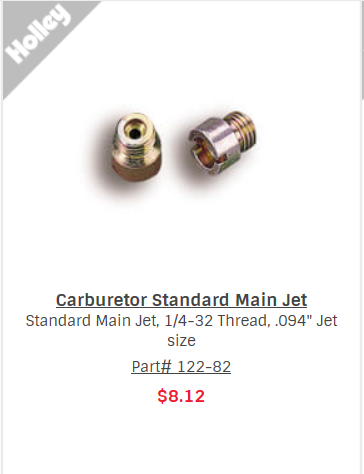

Kawboy wrote: What are the chances of drilling and tapping for a main jet now that you've proven the theory that a reduction in that port is a viable option?
In keeping with his idea of a more "factory" appearance and preferring the flexibility of using a range of orifice sizes I did some digging and found that Holley has jets that have a 1/4"-32 thread and are available with a .094" orifice which matches the 3/32" that I've suggested.
So for you experimenters - fill your boots because they have a wide range of jet sizes to drive you nuts.
