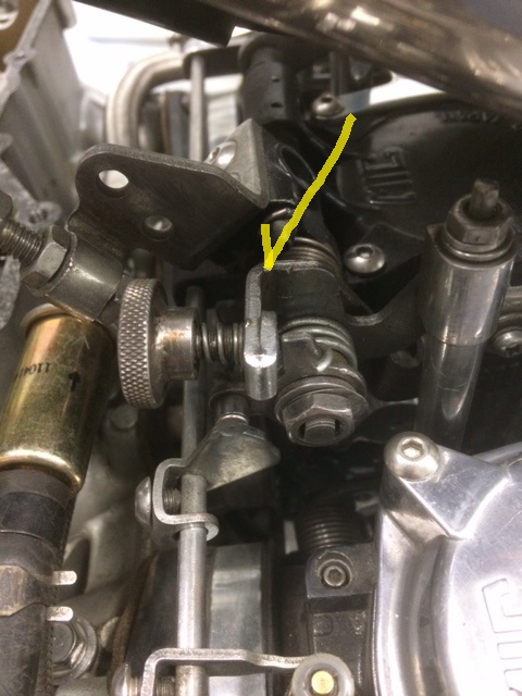

Carb linkages and adjustments: With the age and wear-n-tear on these bikes after all these years and the unknown "tinkering" that has undoubtedly taken place by multiple owners (usually), tolerances can be expected to be "slightly" out of norm. From the initial Manual set-up, the need for some "tweaking" can be expected. For example: The lifting arms for the choke plungers and the fast-idle cam should register in a specific position - every time - when the screws are tightened. The tightening screws have a Point - no pun intended. This point is intended to engage the groove on the choke actuating shaft. Over many years, usually several owners and countless "adjustments it's probable that the contact area on the choke actuating rod has become damaged/deformed. In this case the plunger arms will look like they're all positioned identically but if they are out by several degrees (relatively), several things are now established. The choke plungers will now start to lift at slightly different times (relative to each other) and the same can apply to the fast idle cam. This alone can make setting-up the carbs correctly for cold-starting, a challenge. This has no affect on the sync of the carbs., which is a separate entity.
Another issue which can compound the problem is the fast-idle cam set-up. The small Philips screw used to adjust the differential between the choke plungers "start-to-lift position" and the throttle-plate position can be a problem. If the screw holder (bracket) has been bent and is no longer 90 degrees, the efforts to get the required "Gap" will be compromised, if it can be achieved at all. If the screw-bracket has been bent toward the rear of the bike then No adjustment can be achieved. If the screw-bracket has been bent towards the front of the bike, then adjustment can be accomplished - just more of the screw end will protrude. Any "slop" between the parts due to wear-n-tear will have an adverse effect on the set-up. We've got to remember - The manual dictates these adjustments for a NEW bike. We're left to do the "tweaking.

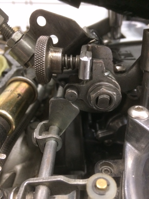

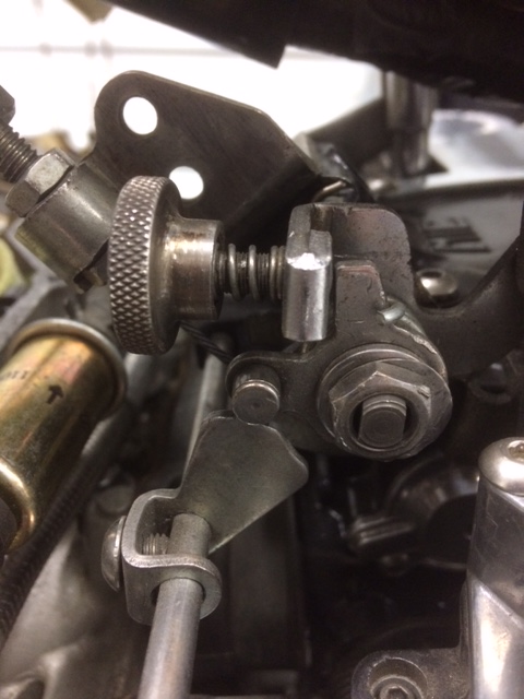

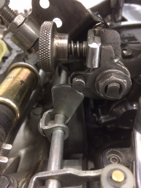

The yellow line points out the 90 degree bend in the fast-idle adjustment screw bracket. The following 3 photos show the position of the fast-idle cam as set-up on my '80. The first is with the choke lever applied slightly - the cam-roller on the cam with only the throttle-plates cracked - NO choke lift. The 2nd shows the roller/cam with plunger-lift initiated and a "bit more" throttle plate opening, with a bit more of the choke lever applied. The 3rd shows the roller in the indent at the end of the cam. This is max. lift of the choke plungers and the throttle plates are closed , with the choke-lever fully applied.
I prefer to remove the Philips screw and use a modified version. The advantage should be obvious. Hope this helps.
