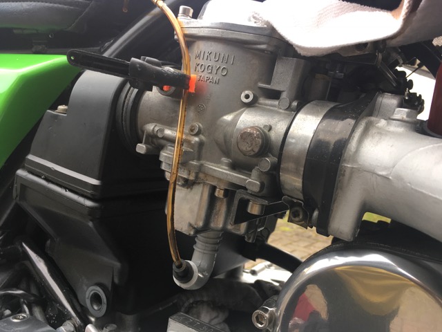

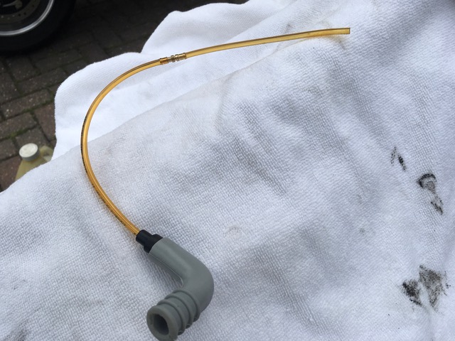

Hi, I have the same problem. These Zs simply do not start after a few days of non use, my US kz was exactly the same. The problem I have just solved concerned spitting through the carbs at just above idle. I suspected the float levels as the mixtures had been good enough before I changed the needles. I was glad to find the right hand carb fuel level was 3-4 mm low, this was indicated by whiteish plugs on numbers five and six. I have set all carbs to 7 mm from the mating face between the float bowl and carb body. The level checker is made from a nitro model exhaust deflector and some nitrile pipe. The float bowl has to be drained first and this fits perfectly over the drain plug mounting point.

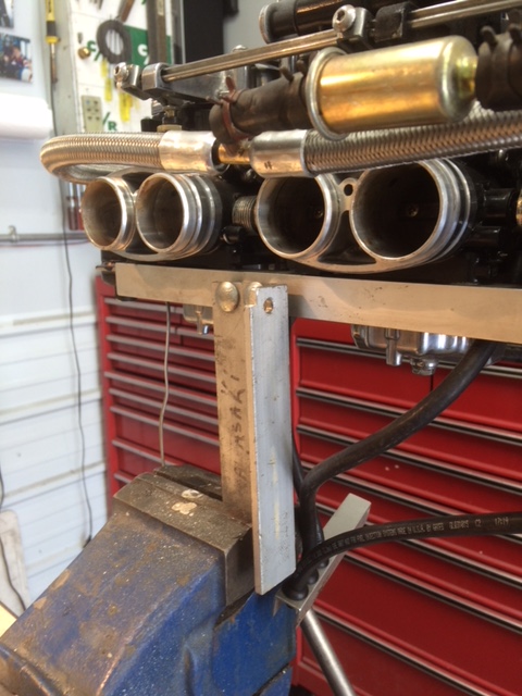

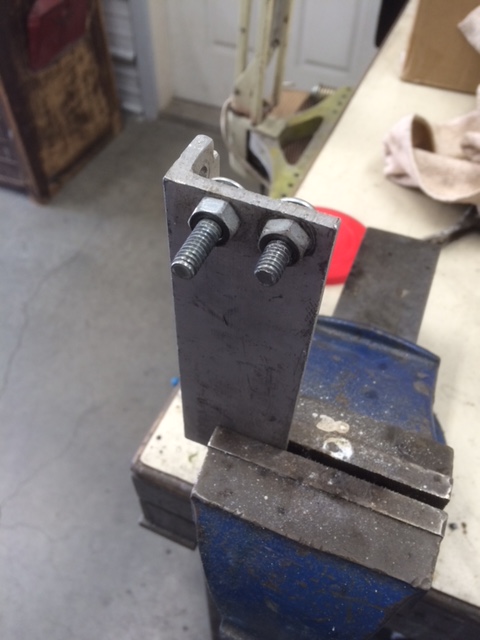

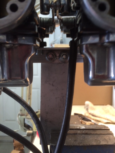

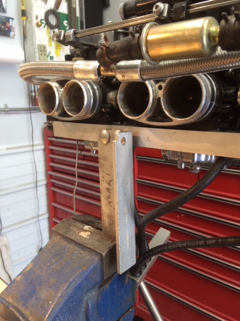

Regarding setting the float-level and "how level do they need to be?"
YES, the carbs when mounted are at (about) a 5 degree tilt DOWN towards the engine. NOT an issue ! A "Leveling Cradle" is a good idea. Any manner of holding the carb(s) steady and level on the bench is a necessity ! I have two methods for doing this depending on whether I'm adjusting the float levels with the carbs as a complete set or individually. This is how I hold a "set". The Carb-mount needs matching two holes.
