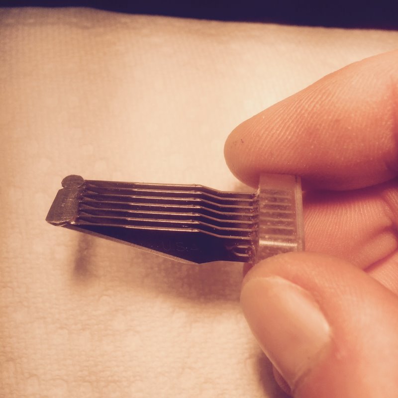

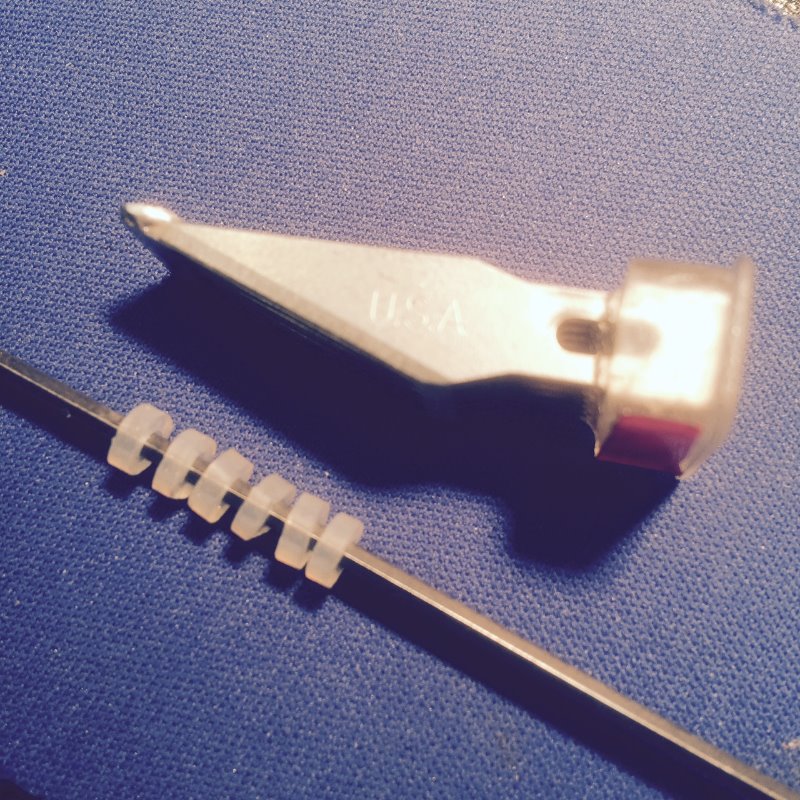

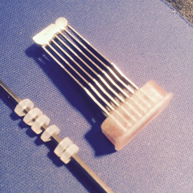

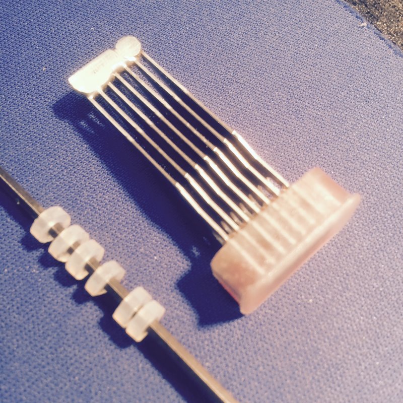

Viton would be the first choice and a standard O-ring 2nd but as "hillsy" points out the o-ring should not come in contact with fuel. About 2 years I covered this, indicating that I made some "Temporary" seals from 1/8" silicone tubing. They worked so well I left them in my carbs and they are still soft and viable and I personally believe they seal better. Since then I made a cutter to produce 6 at a time. Something to consider, perhaps.
