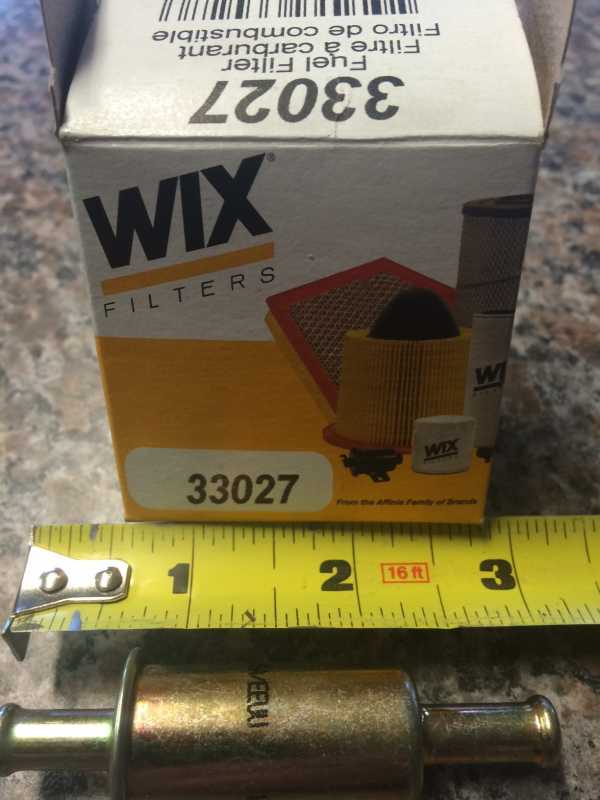

Check the in-tank filter ! It's plastic and has a VERY fine mesh that can get plugged easily. I am suspecting rust/varnish. If it can't be cleaned then remove it and install a good in-line filter. Then pull the cone from the petcock body and check the porting. I've seen these filled solid with rust. Then remove the carbs, remove the bowls, floats and float needle valve body. I've also see carbs with so much rust on top of the float needle-valve body that no fuel would pass. And check thoroughly ! An illusion will have you think they're clean but they may not be. A spiral nylon tube cleaner and some lacquer thinner followed by some comp.-air will deal with this. If you're going to go to the extent of partially stripping the carbs, go all the way and check everything. My Cleaning Tool deals with the cleaning/flushing and flow checking.
A "fuel-pump" won't fix these or most problems but merely add two more places to leak, load an already weak charging system and give you another elec. connection(s) to give potential issues! K.I.S.S.
I've been using this filter type for years. Metal screen, can be cleaned quickly by reverse flushing it with my Cleaning Tool, inexpensive, readily available and flows more then adequately.

Thats the one I was refering to and maybe I should have explained a lot better. Getting a pump to go down to 1psi is virtually impossible so a 5-6 psi pump and that will do a top job.
