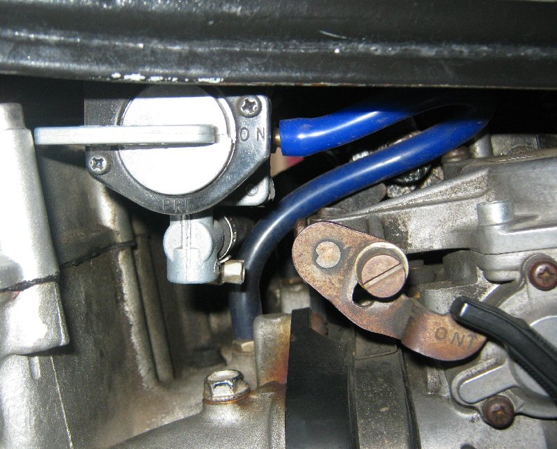

I have a '79, found the "proper" brass nipples that screw into the inlets (new old stock), put 3 in, running a vacuum petcock on mine and only using one nipple (closest one), just make sure the line is as short as possible, turned the diaphragm housing around 180 deg so it faced away from the tappet cover, left a bit of length on the vacuum line so I can lift the tank, all is good, runs great.
New petcock
Nipples

Hi kza13, I see you've used silicone tubing for the vacuum takeoff, I used the same stuff for the vacuum takeoff serving the fuel pressure regulator on my ZG1300. It started to discolour as yours is, then eventually it started to 'sweat' & become very sticky on the outside. What is happening is that somehow very small amounts of atomised fuel is finding it's way up inside that vacuum line & as silicone doesn't like petrol it starts to break down. I swapped mine back to rubber. Just thought I'd warn you, even though that silicone pipe is advertised as vacuum piping it doesn't seem to like our bikes :S
