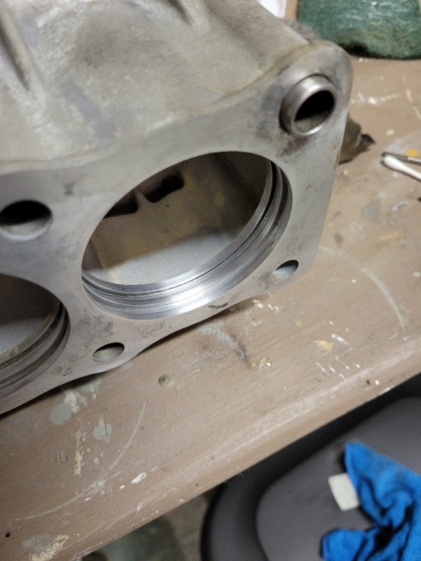

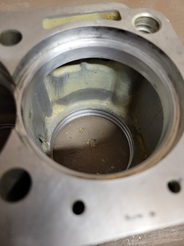

Still working on cleaning up the cylinder block for reinstalling the sleeves. I got about 8 hours into cleaning the block and I still have probably another 8 hours of cleaning left on the block, then on to finishing cleaning the sleeves.
I don't know what Kawasaki used to assemble the cylinder block and sleeves with, but it's baked on and no chemical will touch it. It's delicate scraping and then 400 wet / dry paper to finish cleaning. My fingers are just about wore out and cut from working inside of the 70mm bores of the block.
Bottom side of the block where 2 o rings belong.
Top land on the block where the top ring seals. Top o ring sits in a groove on the sleeve.

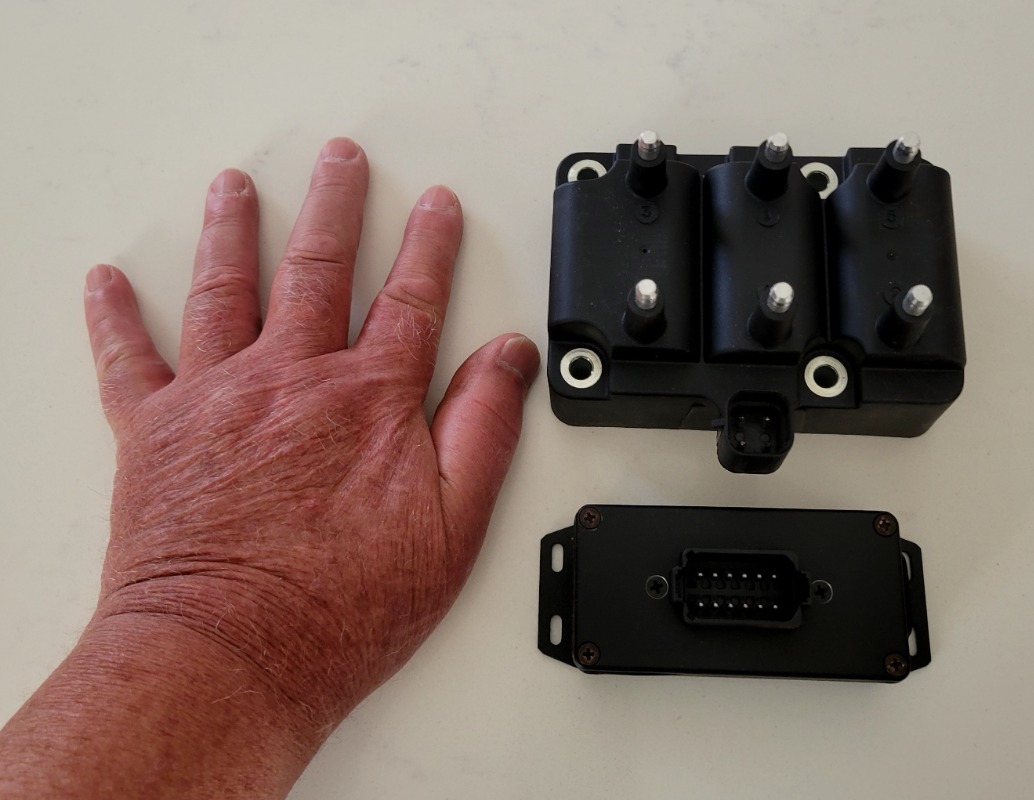

Just got the ignition coil and 4 channel ignitor from diyautotune for the ECU fuel injected aspect. This is to marry up with the Microsquirt ECU. All that's left to acquire is an ait temp sensor a crank trigger and figure out how to mount a 36-1 crank trigger wheel.

This is interesting. I'm really looking forward to seeing your ideas take shape! That's a neat coil pack - hopefully easy to find space for on the bike frame.

That is a beautifully compact "Coil-Block" ! Beats the crap outta dealing with 3 individuals and looks appreciably smaller then my GM coil.
