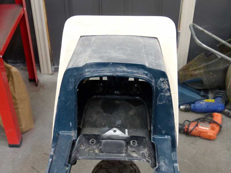

I wonder how many viewers noticed just how well that wing angle blends into the lines of that tail-light. Only if you curved it slightly near the bottom edges would it blend more perfectly. I really like this addition! Question; is there easy access to all that open space inside that tail section for storage? Does it have a closed bottom?

As for your question- I hadn't thought about closing in the bottom so that I could remove the storage box. I'll look at the possibility. It would add a lot more room.

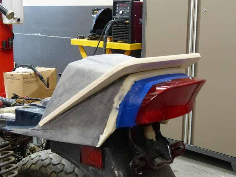

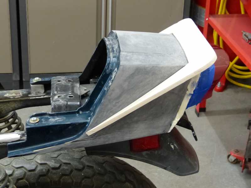

Some more progress on the tailpiece. 2 sheets of 3/16" balsa wood laminated together and shaped on to the wing. Ready for epoxy resin and fiberglass.

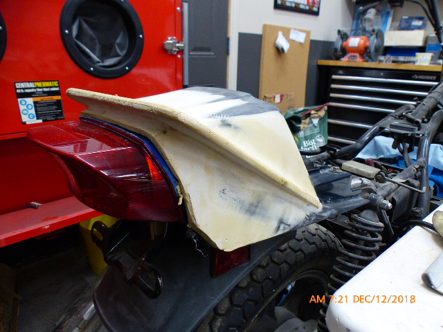

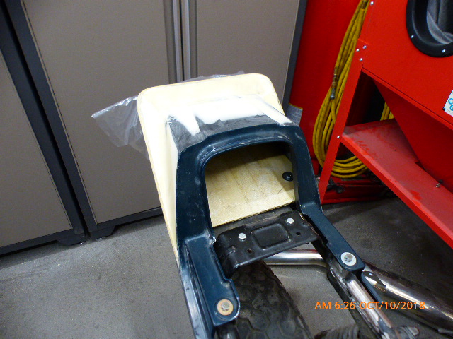

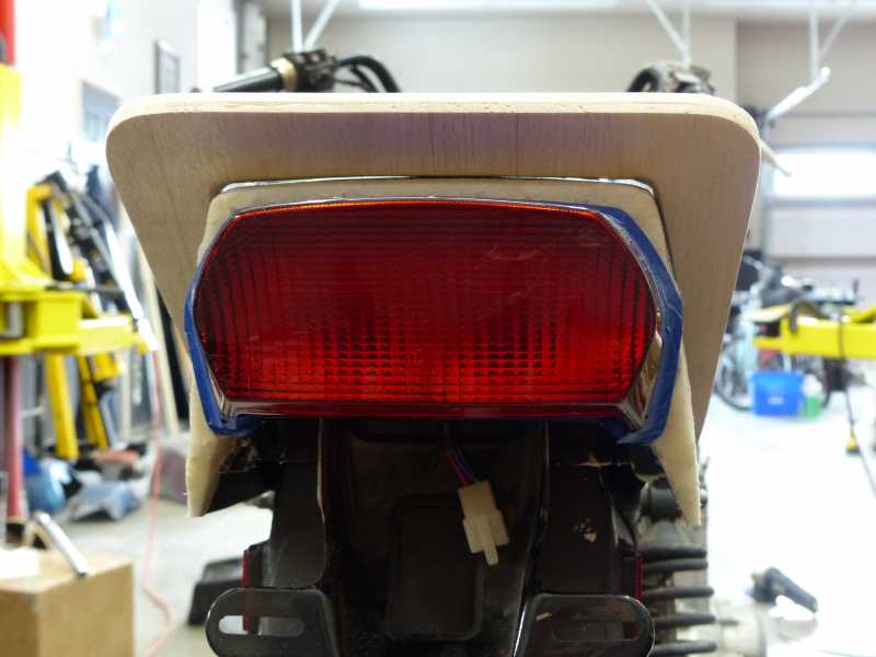

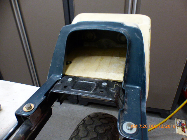

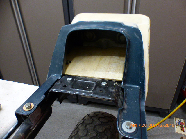

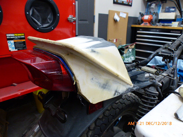

7 years 10 months agoI find myself with little time to work on the beast. Last week was an exception allowing me a couple of hours of "free time" to work on the bike.Frank833 wrote: Update?
to answer your question, most of the faring on the tail piece is done. I'm quite happy with the build out. I can literally sit on the tailpiece and it's as sturdy as a rock. (I weigh 270 lbs.) At the suggestion of Trikebldr, one of our former members, I put a floor in the tailpiece and removed the tool box. The tailpiece is now probably twice the capacity of the toolbox and the box is sealed so nothing will fall out of any of the openings at the bottom. Another couple of hours of work and it will be ready for paint.
I have to say the inspiration is the CBX tailpiece and then finding the GPZ900 rear tail light which just the sexiest light I think I've ever seen. I just had to fit it to the KZ.
1/4" balsa wood sheeting and 2 layers of fiberglas cloth and epoxy used for the duck tail and floor in the bottom.
Got to love this tail light
