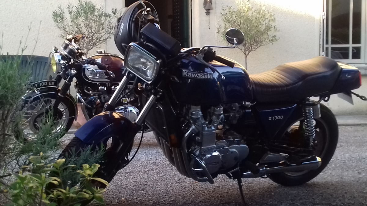

First pic is the bike as I bought it. Other pics are after a few rides

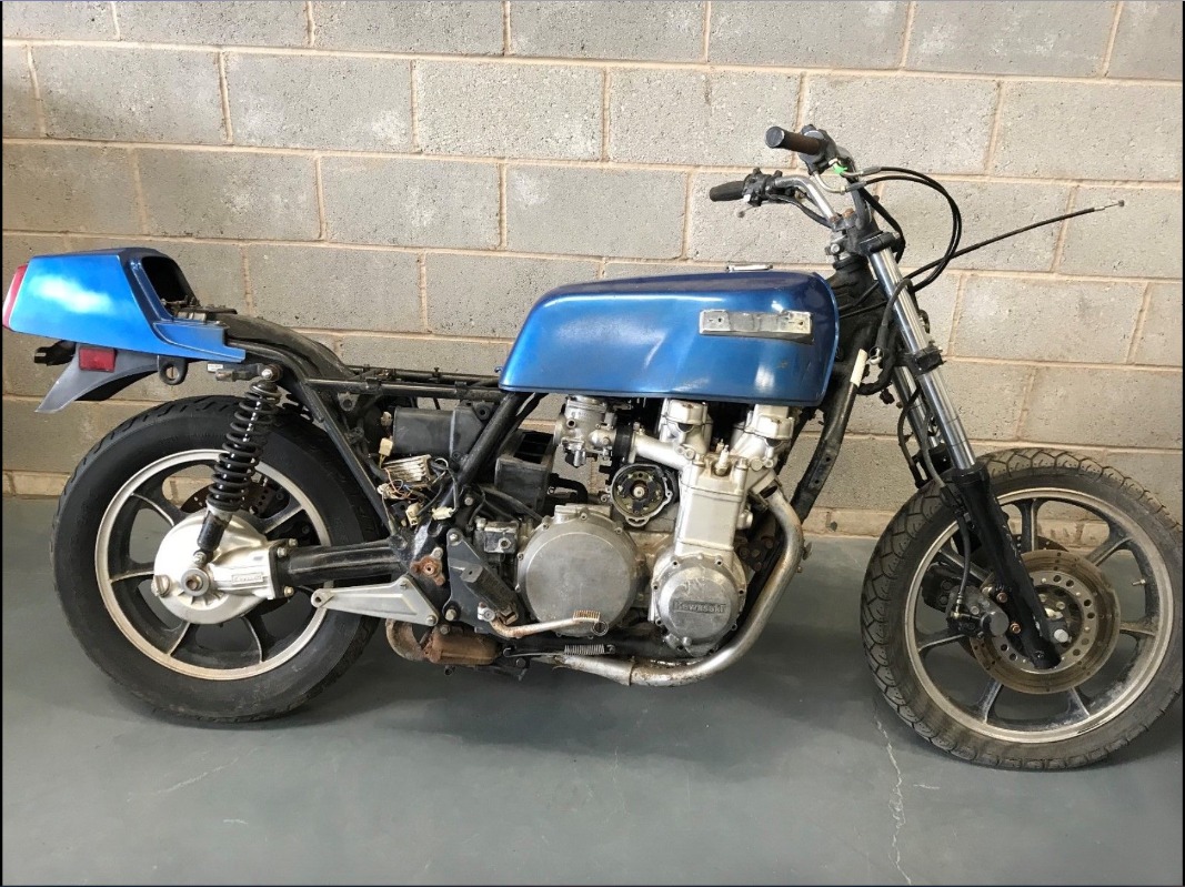

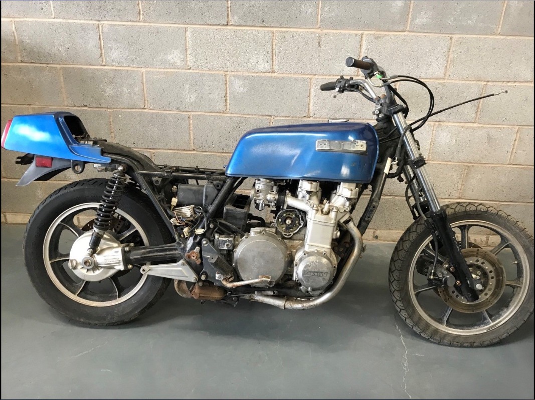

Oh I seem to have lost a couple of pics. Here's the first pic of the bike as I bought it.

That looks fairly tidy compared to what I bought a year and a half ago!
Your rebuild journey will be long, but ultimately very rewarding, and the people on this site will be of immense help to you.
Enjoy the ride (forgive the pun!)

It was fairly tidy when I got it but it was hiding so many problems.
I made a semi failed attempt at straightening the frame myself by making a boxed frame jig around the frame and bolting it to the ground I used a solid metal bar through the headstock which clearly showed how twisted it was. I attached a hydraulic ram and pushed it to the center as best I could. I'll try and find a pic of It.
The bike rode a lot better but it still wasn't right.(well I'll try anything once.) I couldn't find any professionals who could do the job so. Plan B...I managed to find another frame which has already been painted and looked good for a reasonable ish price and threw the old frame on the scrap heap.
I'm hoping this won't take too long as I want to ride it this summer. It might have to be a slightly quick and mildly dirty rebuild. It may be a bit toe curling here and there but it should be interesting. As long as it looks ok and runs ok that'll be enough for the time being.
The bores were very glazed and after some measurements I figured I'd get away with new rings and a hone.
After waiting for over 2 months for some new piston rings UK to France plus huge customs charge, (Thanks to sour grapes from the EU over Brexit) I painted the engine while it was out. and cleaned the valves before lapping them in.
The machine shop did the hone which unfortunately didn't quite clear it. It was close but no cigar.
Damn it! I should have just gone for oversize pistons ...
