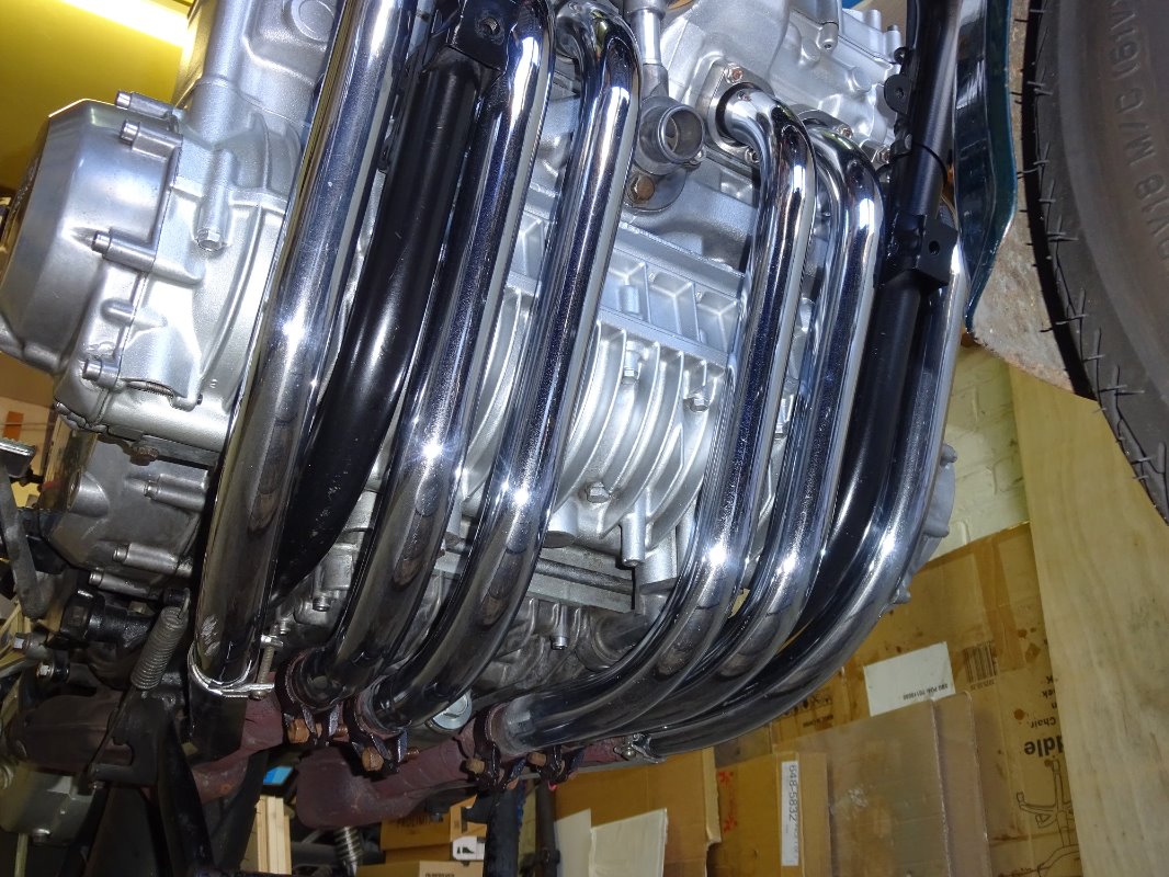

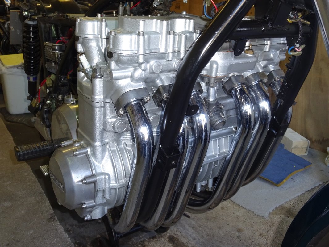

Yes, shame that the radiator covers the headers as it looks so much better without (see pic). Worth noting that the radiator has to dissipate around the same amount of power as the engine at its rated condition - so 120-130 hp or 90-100 kW. However, this level of heat rejection usually occurs at very high speeds so there will be a good flow of cooling air. The most challenging condition for the radiator is relatively low speeds and high loads - such as long uphill gradients in very hot weather. I am sure our 1300's would also benefit from a more powerful electric fan for those hot days in stop start traffic. Even more roasting for the rider!
