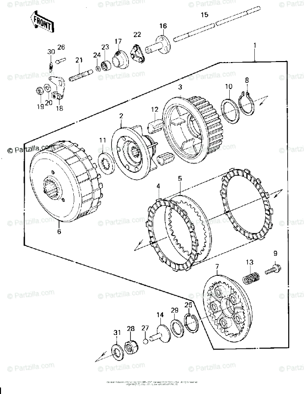

I see you still have questions.. I am with Kawboy. The adjustment screw seems to be far out. When actuating the clutch, it seems to be going in but doing nothing.
A question I have - did you remove anything from the inside? The push rod? If so, is the steel ball (part of the assembly) inserted?

Stan makes a good point. If the push rod (item #15)came out then it is possible the ball bearing (item #27)fell out as well. It's 3/8" diameter and would account for your troubles here. Looking at the first video again, I don't see the actuator ramping in at all which tells me that possibly something is missing (likely the ball bearing only if the push rod fell out and you put the push rod back in not knowing about the ball bearing).
