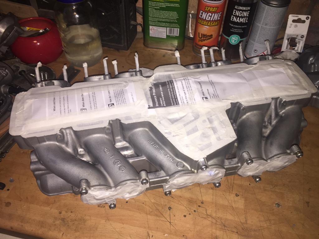

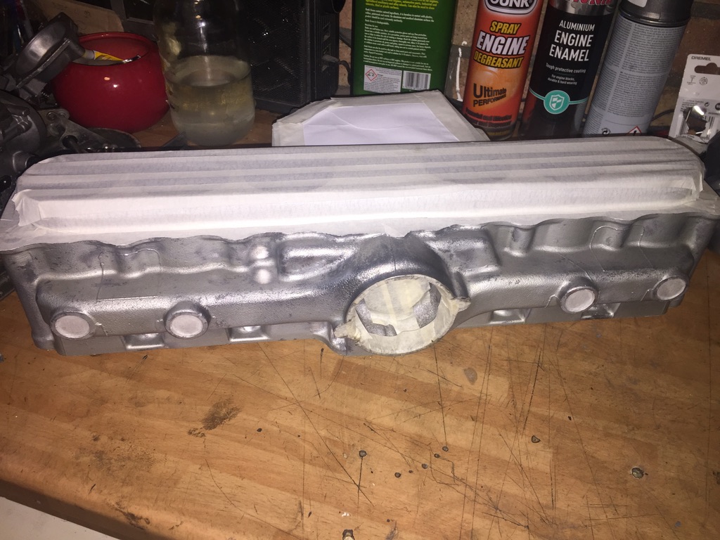

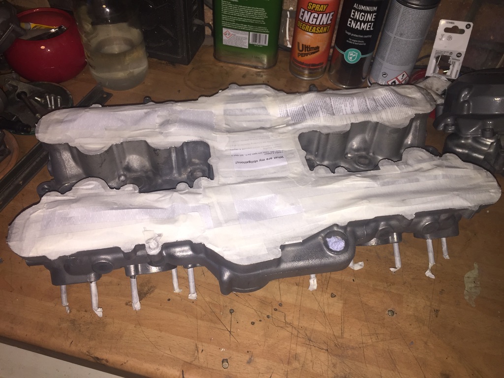

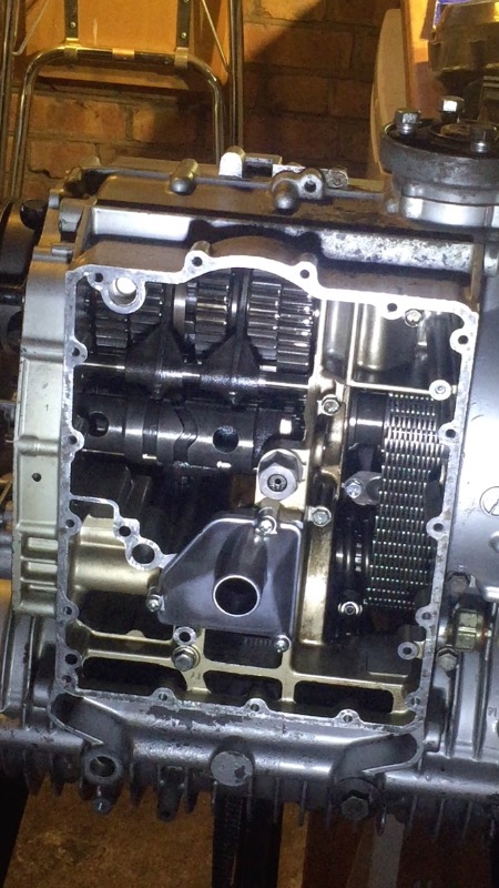

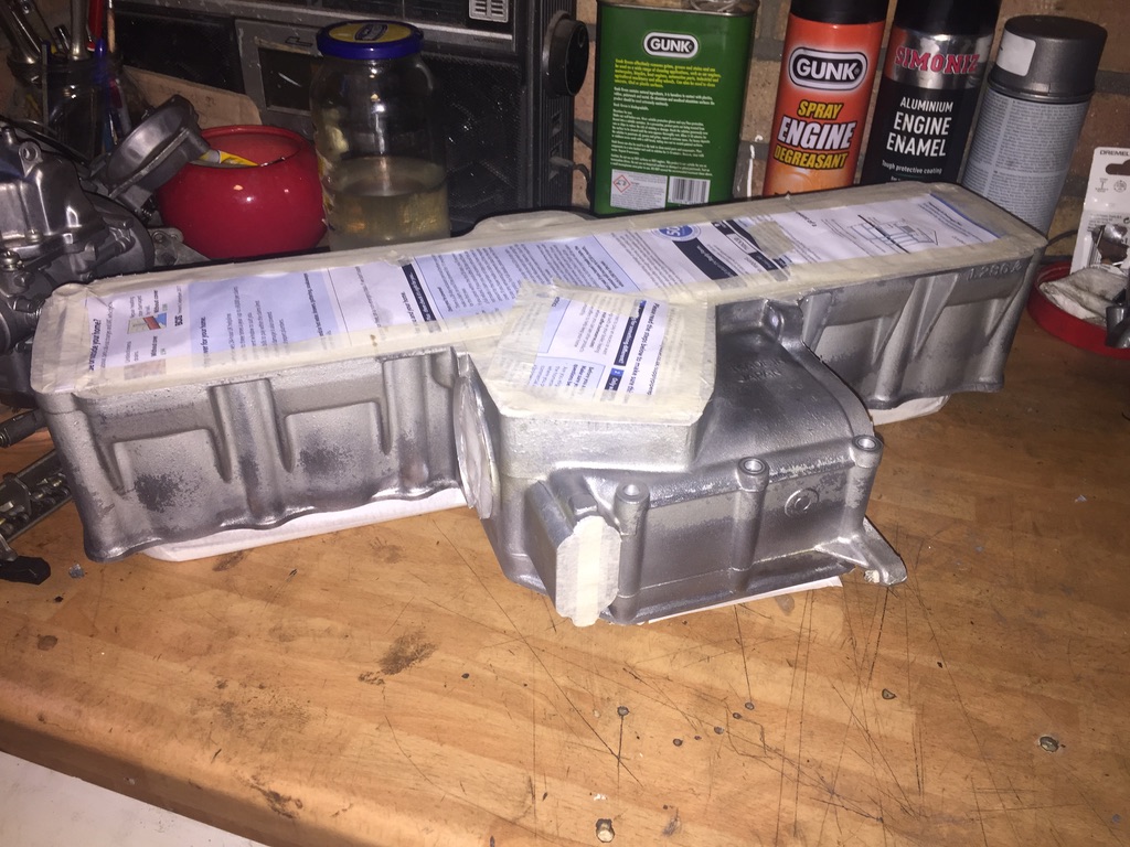

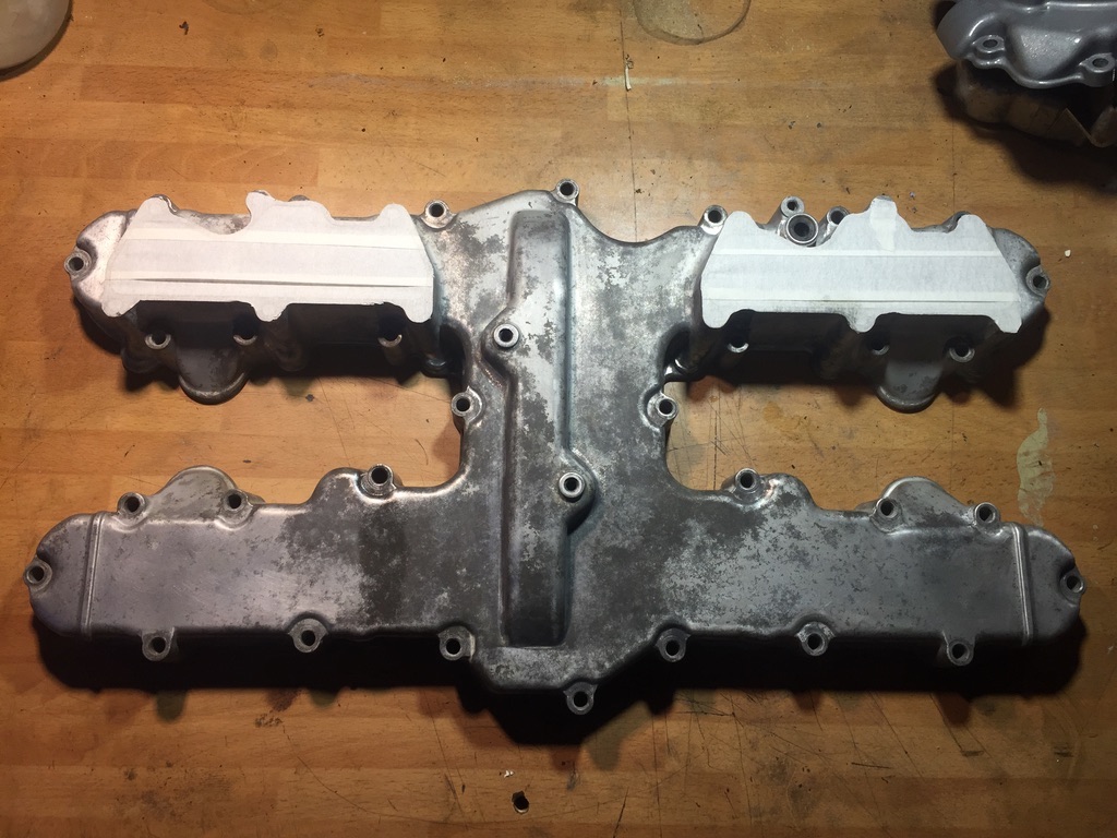

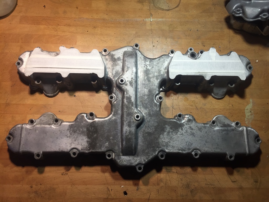

Latest is that I have prepped the cylinder top, tub and head for paint (what a pain!). Once the rain stops, I can move the car out of the garage to create room to spray paint the bits. Pics attached, also from the underside to show the condition of the gears etc - for the other thread.

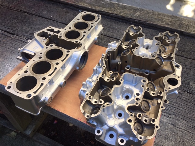

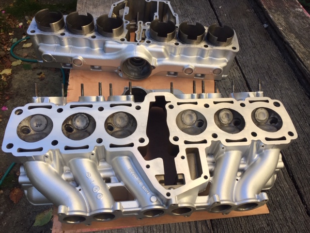

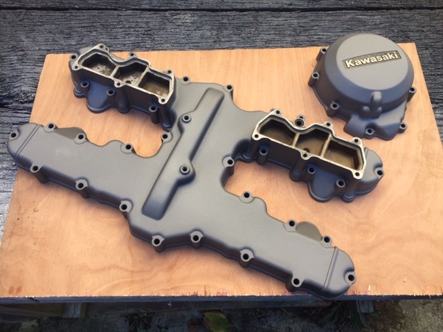

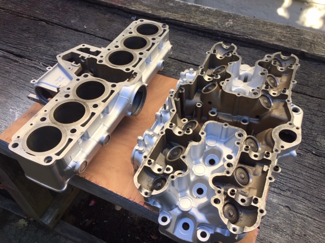

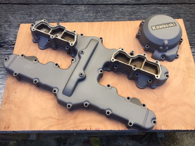

After de-greasing I popped the bits onto my outside work table and spray painted them using rattle cans. It was a completely still day with great sunshine and the temperature was around 18 degrees C, so perfect for outside painting.
Now they will go into an industrial oven big enough to house these large bits (not mine at home!) to bake at 200C for an hour and then the paint should be rock hard. Only the grey bits will then get a clear coat over them to make then shiny, but overall I am very pleased with the result.
For people who want to know: the silver is Aluminium Engine Enamel from Simoniz and the grey is Dark Anthracite heat resistant from Motip.
Now I need to start thinking about taking the crankcase apart to replace the primary and secondary chains, or get someone else to do that... and then paint that - finding an oven big enough for that will be a challenge.... I may just leave curing to when the engine is running...
