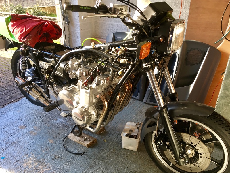

The current state of it. I have bought and modified a Predator 6 into 1 pipe and used a Black Widow end can. I fired it up the other day and it sounded way better than I thought it would. I leak tested the carbs again and squirted a couple of cc’s of petrol into each plug hole. It fired up first time. The radiator was left off to check the sealing of the exhaust, all was good.
Time to create page: 0.301 seconds
