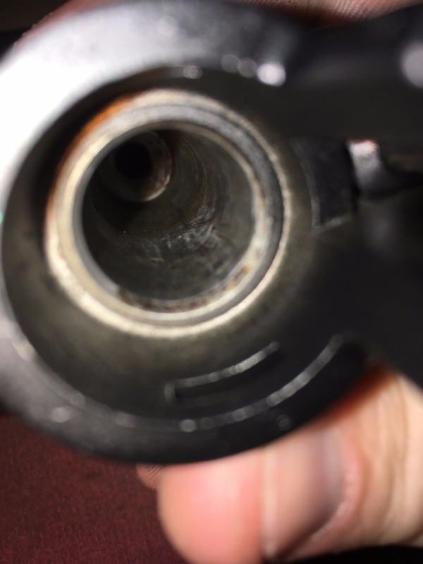

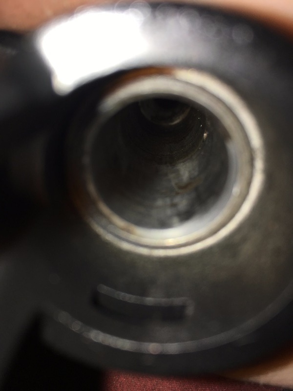

When I first got the bike I spent some time on the rear master Cylinder, as it was in a troubling state. When I first disassembled the rear master cylinder the bore had a nice rust coating along with the piston, which looking back now, seems to be some kind of after market one. The seals were supple but questionable. So I Just disassembled it all washed it out with water and stored it in plastic bags to worry about later, I also had quite the time removing the rear brake switch, which didn't end well. You would think it is as easy as just pushing those two tabs in and pulling or twisting ... So I had resided myself to some sort of hydraulic rear brake switch at the time..
Jump forward to now, I have just had the chance to go through the spare parts that came as extra's with the bikes, and guess what I found another complete master cylinder. Still in a sorry state. So I tore into that hoping; for a good diaphragm ... well it wasn't; its in a worse state then the original one. The Bore on the other hand was in much better state. So I took the time to make a DIY honing tool; a close to 5/8 diameter piece of wood wrapped in 1500 grit sand paper with some oil. This was dodgy at best but did the trick. I tried the same on the other Master cylinder but had to go to 800 grit sandpaper to cut the rust off, its smooth now but still has rust in the bore.
So being optimistic I took the better of the two and used the original piston after some polishing to seem if it wouldn't leak. I rigged it up to a GPZ900r Caliper with some brake line from a Gt550, and it held pressure, regrettably I found out why this cylinder was spare parts the piston was worn or at least the seals.
This is a bit off topic, but I also had to do some brake work on my Z500 which conveniently uses the same 5/8 front master cylinder as the earlier Kz1300's. I had a problem with it not holding pressure and ended up buying an after market piston with dust cover. Which I soon condemned as bad and then proceeded to get a OEM one which was available from Kawasaki. When ordering the person putting in the order put in the wrong part number of by an increment of one, and when I checked it it was the number for the KZ1300 rear cylinder, see where this is going. So in the end the brakes on the Z500 were working, it was all related to the brake lever. Now I still had this spare aftermarket piston laying about for a year+. So when I saw the piston from the rear master cylinder I though too myself shit this is similar, and wouldn't you know it. The only difference was the end of the piston where the actuation rod slips into.
So taking a risk I took the seals of the aftermarket piston and slipped them onto the aftermarket looking rear MC piston. Slipped that sucker in the bore bleed the system and I had a non leaking working MC, I was so happy I decided to tear it all back down and sandblast the sucker and slap some black paint on. now I can write the rear master cylinder mostly off. Just need a diaphragm form it, thinking of getting some from that German site.

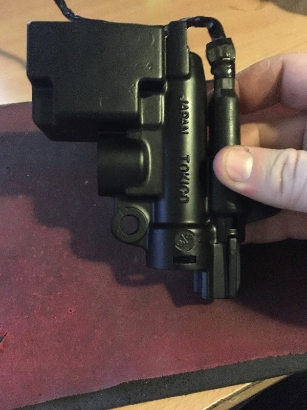

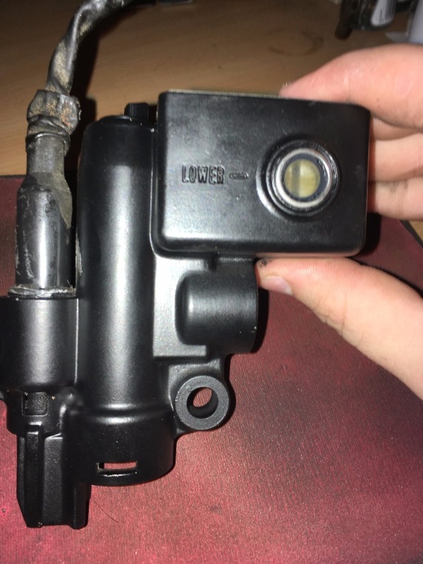

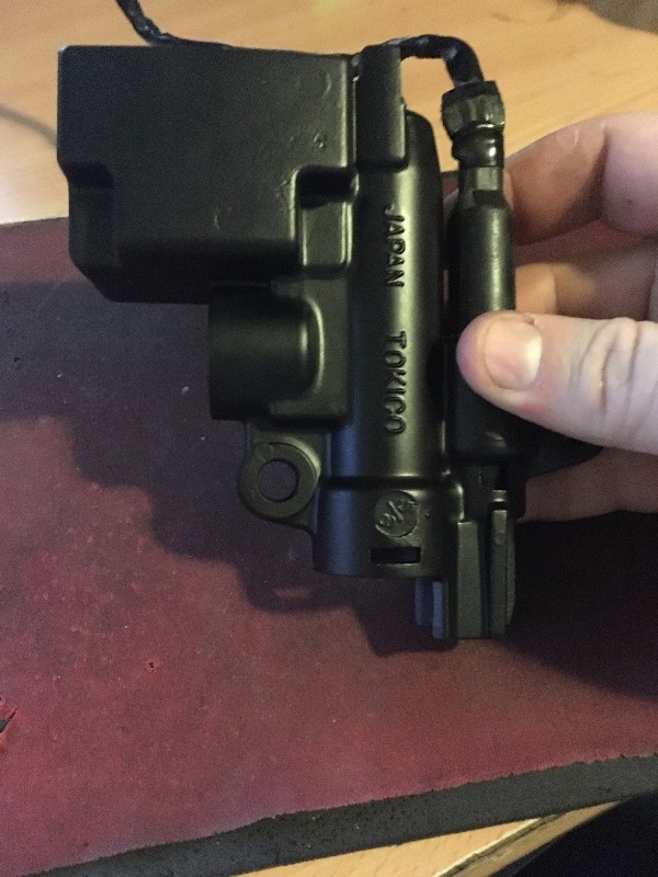

Below are some photos of the rear master cylinder after painting, not perfect nor is the Bore, still considering getting it re-sleeved possibly. For now it seals, and I have plenty of time to mull over it before the bike is ready for the road.
